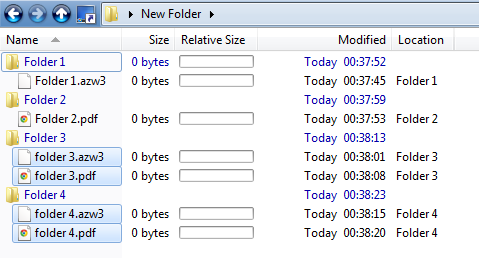

If you go to the parent folder, then turn on Flat View so you can see all the files below it, and run a button with this command...
Select *.azw3 DeselectNoMatch Select SimilarBase Select *.azw3 Deselect Select SimilarBase
...it will select all the files that have both *.azw3 and some other extension. (Not necessarily .PDF, as it does not confirm that. If you need that then it can be done but might be a bit more complicated.
I used your code and a filter. The filter was needed to hide everything that wasn't ".pdf" and ".azw3" but still had the same base name. That will do for now. Thank you.
