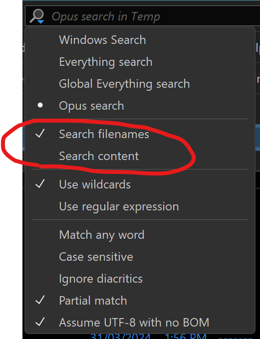

Easiest way is via the Tools > Find Files panel, which has a field for searching contents.
With the toolbar search field, I think it can be done as well but it requires some extra typing every time.
A Find-As-You-Type mode could also be added via scripting which searches for content using non-indexed searching, if it’s something you need a lot and don’t want to do via the larger Find Files panel.
The Opus search field can search content, you just need to turn the option on:

but as I told, Opus-search has problems to find strings in documents - both using the files panel (Shortcut Ctrl+F ) or the toolbar search field. This is the reason for my request :wink:
Of course "Use wildcards" and "Search content" were checked and I also made attempts with many other combinations.

On the left lister I did a search with Windows-search, on the right lister I searched for the same string with Opus-search. In Opus-search "Use wildcards", "Search content", "Search Files", "Partial Match" and "Assume UTF-8..." were checked.

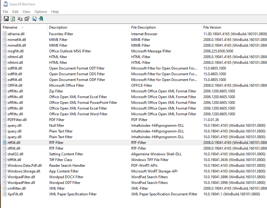

PDFs are not plain-text documents, and searching inside PDFs requires an IFilter be installed. Many PDF viewers include one (although installing another PDF viewer can break it).
This is the same in most search tools, not just Opus, and includes Windows Search (at least to my knowledge). I'd expect the same content to be found using Opus as anything else (including Windows Search within Opus), aside from differences that come down to indexing (Windows Search might not find things in a non-indexed folder).

Opus (and pretty much everything else) requires an IFilter be installed for those as well.
Those formats are not "normal text files"; they're encoded in extremely complex, proprietary formats. Open one in a simple text editor to see.
Unlike plain text files, they require code that understands their formats to access the text data inside them.
That is what IFilters do, and why almost all search tools rely on IFilters for content searching inside formats which aren't plain-text.
If you have Office installed, it should have installed an IFilter for its formats.
Many (but not all) PDF viewers install IFilters for PDF files.
You can use a tool like NirSoft's Search Filter View to see which IFilters are installed on your system.
Thank you for your patience!
I used the recommended tool to view the installed IFilters. Everything seems to be fine:
