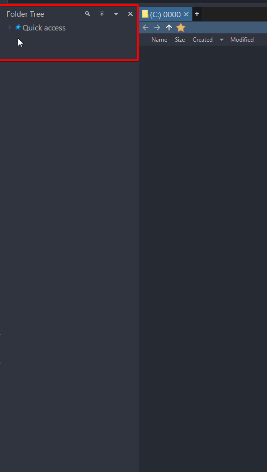

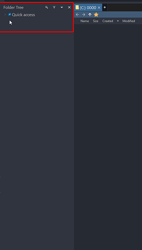

How to keep Quick Access section expanded in Folder Tree?
This never happened in v12. Almost every time I toggle to open the "Folder Tree", the Quick Access section is twirled closed, and I have to click on the arrow to expand it. What can I do to so it's always expanded when I open the Folder Tree?
Note: Usually, it will stay open as I use Opus, but if I close opus for about 10 minutes, and come back to work, this happens.

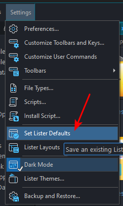

Expand it and try Set Lister defaults.
That seems like a good idea, but it says "and open folders", which I don't want to set the open folders to open each time I open Opus. Currently, a new lister opens to the folders I recently had open. Any idea how to do your suggestion while keeping that?
Ok, I see it says it doesn't affect layouts, so I gave it a try. I'll update if it helped after using Opus for a while. Thanks!

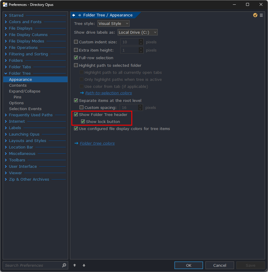

Use the lock button.

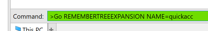

While the QA folder is expanded, run
Go REMEMBERTREEEXPANSION NAME=quickacc
once.
Add
Go RESTORETREEEXPANSION NAME=quickacc
to your Folder Tree button.
@skinz The lock becomes unlocked each time toggle the Folder Tree open.
@lxp Done. I will use Opus for a while and update if it helped. By the way, I had to create a button to run that code, and then removed the button. I don't know how to run code without an object. When I open the CLI window, it contains an existing code of my toggle button, and I don't know it clearing it would remove my code from opus.
Nothing wrong with a button. Alternatively, you could use the FAYT field's Command option.
Find-as-you-type Field

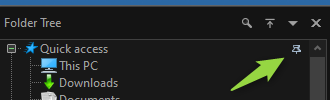

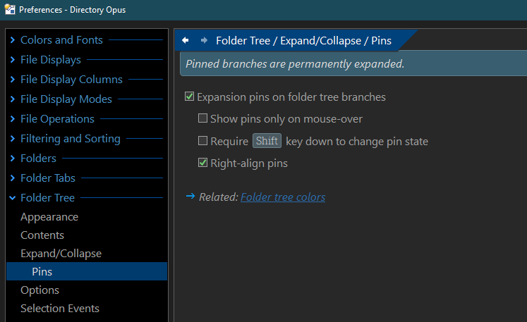

Have you tried pinning it
Ok, pinning it is the only thing that won't allow me to twirl it closed, which is a good sign. As always, I will have to use Opus for a while, and test it. Thanks, this sounds promising!

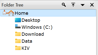

Sorry to piggyback on this thread. May I know how can I get "Quick Access" shown on the Folder Tree? All I'm getting is "Home". Thanks!
opus
That's just the difference in name between Windows 10 and 11. In Windows 10 it's called quick access and in Windows 11 it's called home.
Nope, didn't work. I've closed Opus a few times, and it was working, but I just opened it now, clicked on Folder Tree, and the Quick access is twirled closed, and it was unpinned! So stubborn!

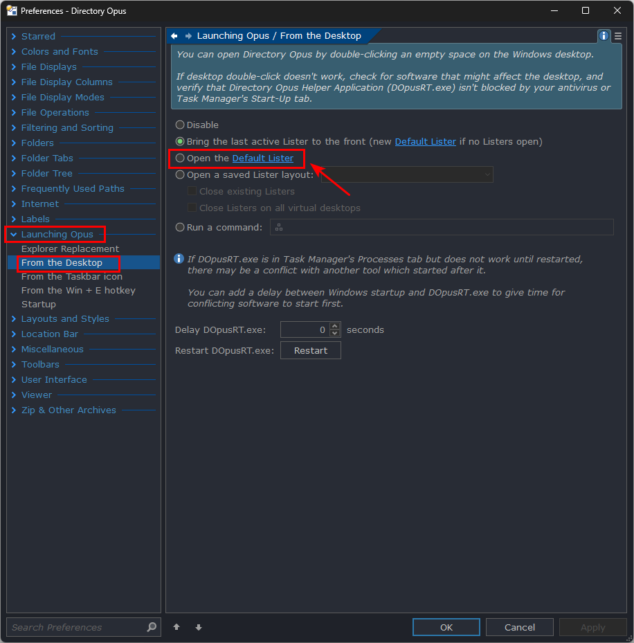

I suspect that when you double click on the desktop, dopus will open your default lister where your default lister is set to collapse folder tree.
If the problem is like this, try locking the folder tree and saving it to the default lister.
2024-01-29_101055
Great suggestions, but unfortunately, not our solution. I've already done save lister default before.
My run from desktop is disabled. I use Stardock Fences, and have double-clicking the desktop set to toggle the icons on the desktop. I open Opus by double-clicking its icon in the system tray of the taskbar.
