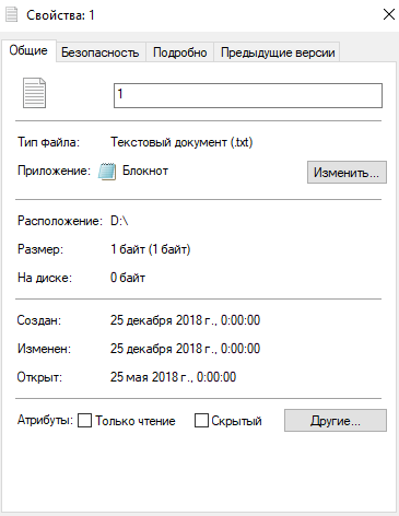

For example, SetFileDate can change access timestamp, but I wonder if Opus could do the same.
Do you mean this software: Freeware – No Nonsense Software? Does it really work? It might have worked back in 2006 with WinXP, but it doesn't change the access timestamp on a Win10 system.
Yes, it still works.
On the screenshot (made on Win 10 Home with latest updates) you can see it.
It's in Russian:
Создан: (Created) - 25 декабря (Dec, 25)
Изменен: (Modified) - 25 декабря (Dec, 25)
Открыт: (Accessed) - 25 мая (May, 25)
2018-12-25_11-01-13
