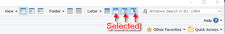

On my wife's computer, the Viewer Pane & Metadata Pane are at the bottom, when we would like those to be at the right. The Lister buttons 2,3,4 are selected. When clicking buttons 3 and 4, they only toggle ON and OFF the Meta & Viewer Panes.
In the above description, it says:
Change the button to "Set METAPANE=Toggle,Vert"
which should resolve my concern. But HOW do I get to the Buttons (since they only toggle)? and HOW to set it to CHANGE the button to what is above,
i.e. the "Set METAPANE=Toggle,Vert"? And do I need to do same for the Viewer Pane?
