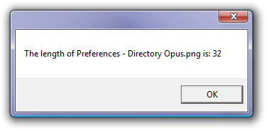

Well, since no one else jumped in, here is a crude and old way to do it, but should get you started:
Create a small VBScript file, like flen.vbs using notepad or some such plain text editor.
dim fname, arg
set arg=Wscript.Arguments
for each fname in arg
msgbox "The length of "&fname&" is: " & len(fname)
next
Now create a button named file length and put this in the function field:
wscript.exe c:\users\administrator\documents\flen.vbs {allfile$}
substitute the actual path for "c:\users\administrator\documents\flen.vbs" which is where I put it to test. It should give you a message box for each selected file. You will have to allow wsh scripts to run. You can modify it to do whatever you want with the results.
(allfile$} gives you just the file name, {allfilepath$} will include the path.
Lou
