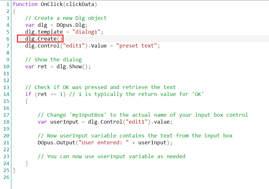

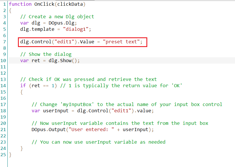

Hi, all. I created a custom dialog named "dialog1", and I put an edit box named "edit1" control in it.
I intention is to put some preset text in edit1 control. but the red box line gives error.
How to fix?
Thanks.
You need to call Dlg.Create before setting the value. I think that is all that’s needed.
Ok, I added what you mentioned, but the dialog flashes very briefly.
Might need dlg.detach = true; before the dlg.Create();.
If that still doesn't work, please paste the code as text so we can try it.
For a "real" dialog, you probably need to call
dlg.GetMsg();
and check
dlg.result
Not working.

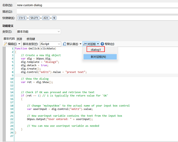

We need the Resources tab's text as well. (Or copy & paste the whole button, from the toolbar.)
Thanks, but I have no clue how to integrate your code with mine. I simply put it somewhere I see fit, it just gives error.
Maybe we have located the origin of the error. I don't use button or resource tab. I simply created one marked with red box.
I pondered a while and I think maybe you are talking about this:
new custom dialog.dcf (2.7 KB)
