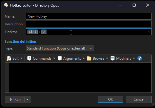

I've included an image of the window I'm using to create my shortcuts - just to avoid any confusion. When I recorded this shortcut I was pressing the Alt key as well as the Ctrl and D key.
2024-06-08 05_54_36-Customize - Directory Opus
FWIW, it's working OK for me, testing with 13.6.8 on Windows 10.
A couple of possibilities:
  • The OS may be confused about the state of the Alt key(s).
    Tapping both the left and right ones, while the hotkey editor is active, should fix that if it's what's wrong.
  • Something might be intercepting the Alt key (when Opus is active).
    That could happen if you're using AutoHotkey or similar and there's an error in the config, or with some keyboard drivers that have per-app settings that can reassign or disable keys depending on the active window.
