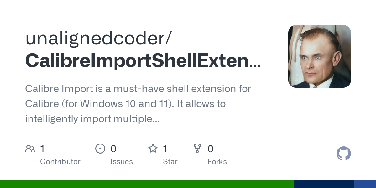

Hi. If you are still interested, my Shell Extension can be found here:
The file you should check is:
You may be able to build the shell extension with and without the line: [COMServerAssociation(AssociationType.AllFiles)]
and verify differences in behavior when selecting multiple ebooks.
Anything interesting you find out please let me know, could be there are improvements I can make on my end to solve this problem.
