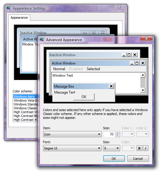

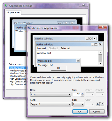

The large and small icon sizes come from Windows (and the large is 32x32 by default, not 30x30.)
You can change this from the Display Properties (classic Appearance Settings in Vista), but just changing the number doesn't magically mean every program is going to have a nice icon at that size - most icons will end up scaled and jagged.

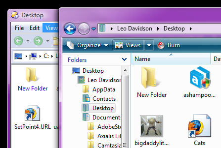

This shows how Directory Opus 9 looks better in XP than in Vista.
In XP, editing a value in registry (small/tree/list/detail) icon size can be set at will and looks very beautiful. Default folder icons can be customized at will.
In Vista Explorer icons are dynamic in the right browse panel but static and small in the tree panel.
In Vista, Directory Opus 9 have small and not zoomable icons, both in tree and browse panel.
Can you add a feature to set the default size of icons (both panels) as in XP ? Sizes don't need be zoomable, but at least with not-fixed size.

Apart from the Large and Small icon modes there's no way to specify icon sizes in a folder format in any existing version of Opus. You can change that the Large and Small sizes are by changing the appropriate Windows settings, but those cannot be changed per folder format. (You can also change the size of Thumbnails that Opus uses but we're talking about icons rather than thumbnails I think.)

But how can I specify size of icons in Small and Large Modes changing the appropriate Windows Vista settings?

I don't know, sorry. I didn't know it was different in Vista and have never tried to change it. I suspect it would break a bunch of programs that assume it's the normal size.
The setting isn't part of Explorer, it's part of Windows itself. (It's like the settings which define the height of titlebars and the colours of windows.)
