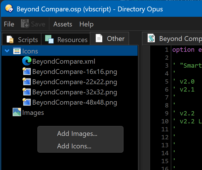

Probably makes sense to handle them the same way icon sets and image resources are handled for script packages:
(Seems you can actually add any file type there, FWIW, although I did not try it in depth or do anything beyond adding it in the UI and then cancelling the change. Maybe it's already possible, if you don't mind it being in the wrong category in the script editor. Having a section for "other" or "binaries" would make sense, either way, as a few scripts need those now.)
Yes, you can put stuff inside the .osp package, but that would be a bit different from what I was suggesting. It depends on what you want to store I guess and for what purpose, and it does have some drawbacks:
  • It still takes up extra space.
  • You can't run an .exe directly from there, so you'd need to extract it every time. (AFAIR, there's no way to programmatically extract it from the package itself without the user having some specific archive-related configuration.)
Instead, if the .opusscriptinstall could act as a kind of one-time deployer, with the ability to specify destination paths (and even create them if necessary), similar to how software installers work, that could make things much cleaner. No special UI would be needed. Authors could edit exportkey.xml directly and include the necessary files.
