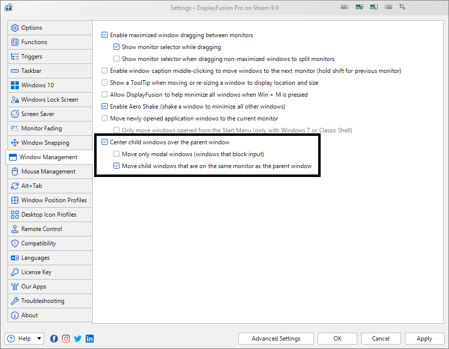

Do you have any utilities installed which move other programs' windows around, make things "on top", change which monitors things open on, or similar?
For example, this is an option in Display Fusion (although it could do with responding a little quicker)
Sorry no as I mentioned earlier my system is pretty much vanilla. I don't use tools which modify the native windows operations, at least not knowingly.

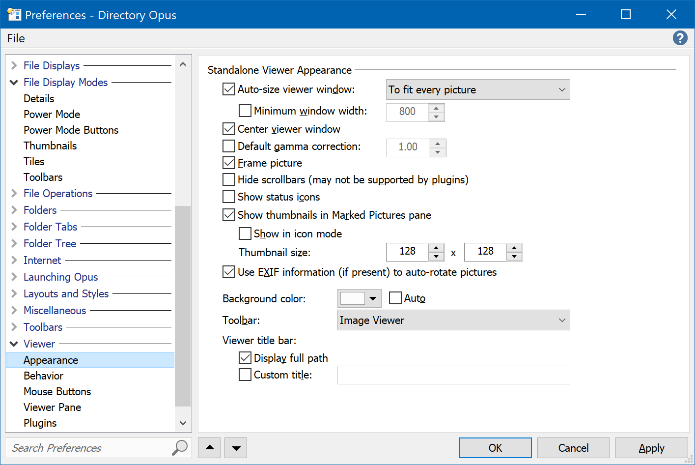

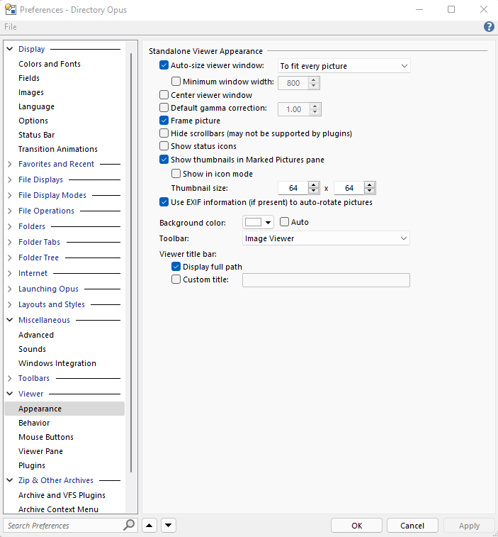

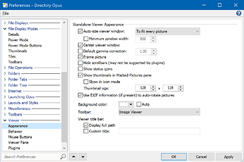

What are your Preferences / Viewer / Appearance settings?
I swapped the two displays around in the display settings and the weird thing is that the problem goes away. Not quite sure what to make of that and why it goes away.
That's the only setting I changed was to remove the image centring .
After that the image display still works the same way as before with regard to the screen it displays on,
ie if the image is on top of the secondary screen lister it will centre on the primary screen centre instead.

Try turning on the center viewer window option in case that helps. Or turn off the "auto-size viewer window" option. It's possible the viewer is resizing to a size which pushes it off the right hand edge of the monitor it was going to open on, which makes it snap to the next monitor instead, perhaps.
