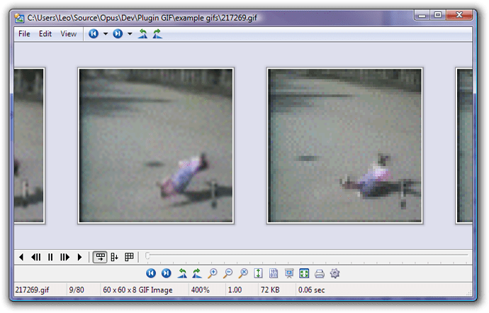

It might depends on the bit depth of the image, at a rough guess. Opus just uses the OS functions for scaling and I can imagine that 24 and 32 bit images might get smoothing whereas 8 bit ones may not. Just a guess though!

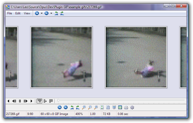

The OS (or maybe it's up to the graphics drivers) decides how to scale some images based on what they contain. It uses some kinda of heuristic.
This causes some oddities with my animated GIF plugin: If you scale up some animations then some frames get scaled using bilinear and others using nearest-neighbour, so the smoothing pops on and off for some frames.
e.g.
Hmm that makes sense. I think it was just some GIFs that were not smoothed when scaled.
If Opus uses OS functions for this, I guess it would not do much good to submit a feature request for an option to turn smoothing off? I remember such an option in the image viewer I used to use, but the Opus viewer is just too handy to part with
Turning off the smoothing is possible but I don't think there's a way to force it on even when the OS doesn't think it should be used. We could use our own scaling function but it'd be slower than letting the graphics hardware do it.
