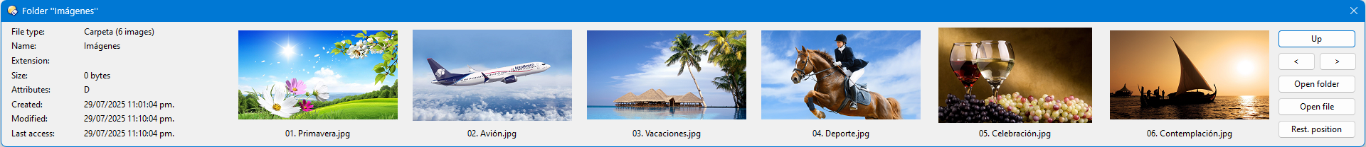

This simple script displays information about the selected item, whether a file or a folder. Thumbnails react to clicks; if it's a folder, it will open normally; and if it's a file, it will open with Opus's internal viewer (I couldn't get them to open with the default program). If a folder is selected, it will be analyzed to see if it contains images; if it does, the total number of images and the first six thumbnails will be displayed. These thumbnails also react to clicks. The script works in any view mode, even List mode. If the window is moved, we can reset its position using the "Reset position" button. The script has two translations: Spanish and English.
Once the script is installed, simply run it using a button in "Standard Function" mode (Opus or external) with the "BarraEstado" command. I can't end this presentation without first expressing my eternal gratitude to @errante for his extraordinary contribution to navigating between tabs and panels.
Note: The width and position (horizontal and vertical) of the window must be customized according to individual needs. To specify the width, do so directly in the script, on line 758; the default value is "1095". To specify the position, use the script's settings button.
