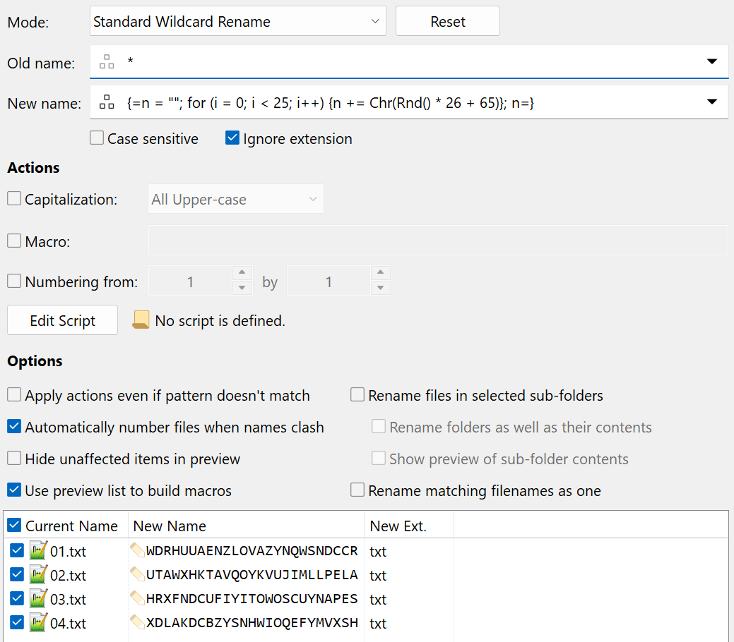

A great opportunity for the Evaluator to show off its new skills :slight_smile:
{=n = ""; for (i = 0; i < 25; i++) {n += Chr(Rnd() * 26 + 65)}; n=}

Many thanks! Works fine now, without repeating pattern!
