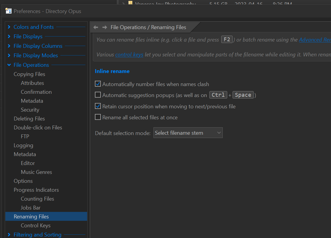

The popup can be turned off via Preferences / File Operations / Renaming Files / Automatic suggestion popups (as well as on Ctrl+Space)

Strange, that option is actually turned off (and always has been).
In fact, turning it off or on doesn't seem to do anything. I even tried restarting DOpus with each change to the setting, and I always get the popup.

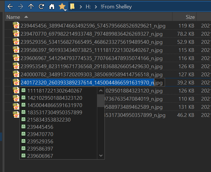

Here's the Inline Rename popup that I'm referring to:

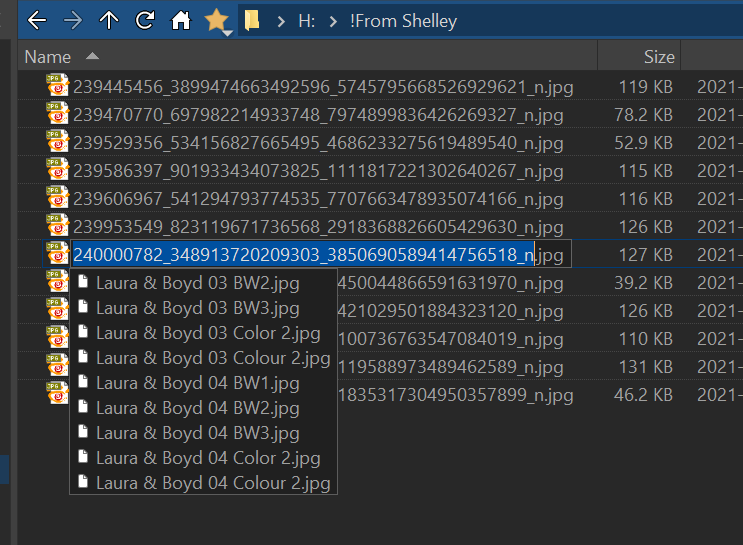

And here's the Ctrl+Space popup (i.e., not the one that I was referring to in my previous posts):

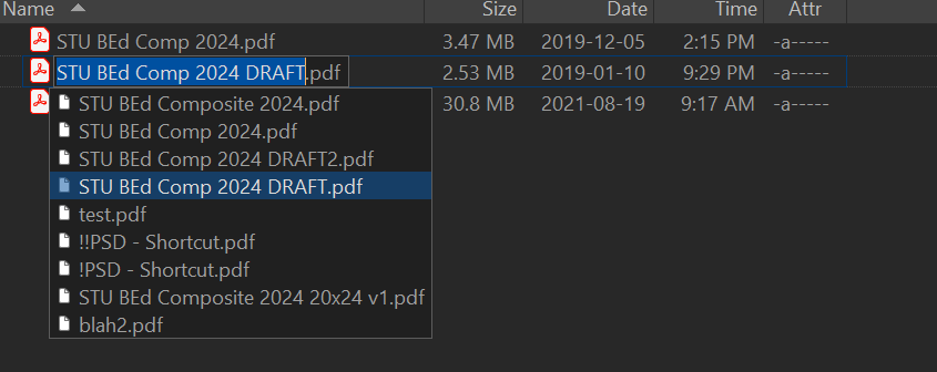

I'm noticing another peculiar behaviour: if I press F2, followed by Shift+Down Arrow to initiate inline rename history, and the selected file's name already exists in the history list, that item is selected (see screen capture). I can't think of any reason why this would be useful, and to me, the top item (i.e., the most recent) should always be selected.
