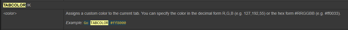

Unfortunately, I don't think it helps me in this particular case because all I want to do is add a top edge to the active tab, and it seems currently only the TABCOLOR parameter is exposed to scripting.
That's what the TABCOLOR parameter changes.
Ah, that’s on me. I misunderstood how the TABCOLOR parameter works. After reading the documentation, I assumed it changed the tab’s background color rather than adding a top edge.
I’ll go back to @Chuck 's script and try to use it as a guide for coming up with what I need.

I have some basic JavaScript knowledge, but I'm not a programmer by any stretch. After a bit of trial and error, I put together a small script that adds a top edge to the active tab. It skips locked tabs, since I've already assigned those a different top edge color via Preferences > Colors and Fonts > Directory Opus Colors > Locked edge color.
function OnInit(initData) {
    initData.name = 'Add top edge to active tab';
    initData.version = '1.0';
    initData.copyright = '(c) 2026 Shai';
    initData.desc = 'Highlights the active tab with a color on its top edge';
    initData.min_version = '13.0';
function OnActivateTab(activateTabData) {
    var cmd = DOpus.Create().Command();
    cmd.SetSourceTab(activateTabData.oldtab);
    cmd.RunCommand('Go TABCOLOR=reset');
    if (activateTabData.newtab.lock == 'off') {
        cmd.SetSourceTab(activateTabData.newtab);
        cmd.RunCommand('Go TABCOLOR #bd93f9');
It works, but I'm not sure if this is the best or most efficient approach. I'd really appreciate any feedback or suggestions on how it could be improved or made more robust if there are glaring oversights.
I haven't tested this long enough so there may be edge cases I haven't run into yet, and therefore I consider this more of a draft for now.
