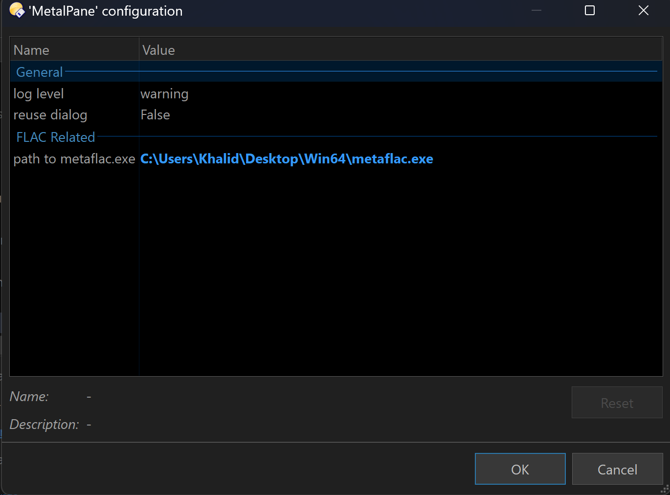

The one that puzzles me the most is the error when setting the metadata. To find out why, change in Config, log level to debug, repeat the process which gives the error and post the whole result.

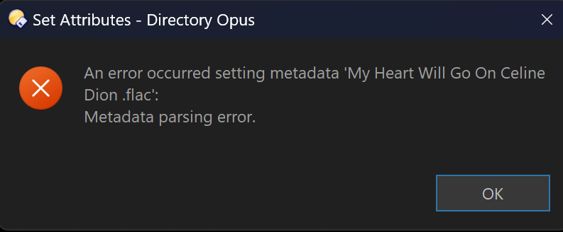

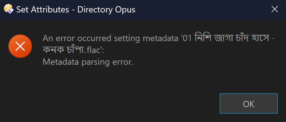

    If after update Albumartist Column data I Click anywhere inside Metalpane it's displayed updated Data in MetalPane But when I Click on Apply Button of MetalPane it's Displayed This Error
If after update Albumartist Column data I press Tab from the keyboard then the Updated Data just Vanished and the Cursor jumped over the next field. So I can't find any way to update Albumartist Column data.

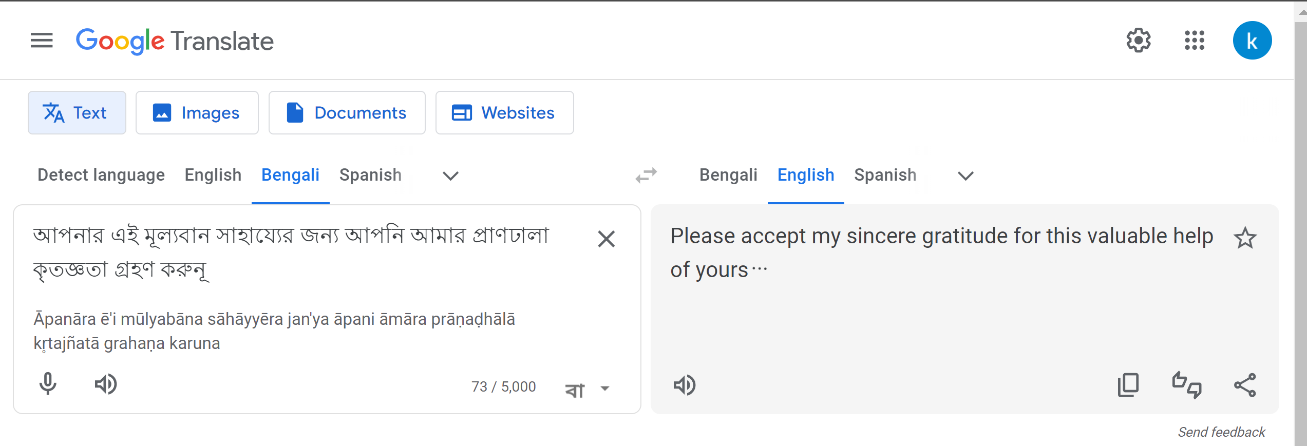

I have no Language for say you THANK'S. This is a very use full Script for me. Please accept my sincere gratitude for your valuable help and This is a demo how I write English language from help of google. :grimacing:
