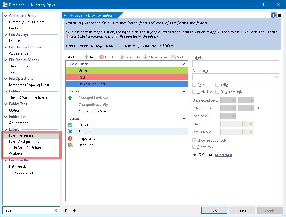

The label itself is defined here:

Does it really depend on file type, or is it the file location? E.g. Local vs network drive.
Have you checked the Label column? It’s possible you’ve configured the Tiles for some types to show labels and not others, in which case the label is there, just not included in the Tile information for that type.
Haven't tested with network drives, but in the Desktop lister, only certain file types are working while others are ignored although they are in the same directory.
Good point. If I enable the label column, I can see that the labels are added/toggled. So it indeed seems to be related to the display definitions. I'll check that later thoroughly. Thanks!
BTW: Is there any other way to display assigned labels? I was checking the propertys but couldn't find any info here.
Adjusting the file definitions fixed this, many thanks! Although I haven't adjusted anything here for years, so this must have happened while importing the settings from DO12.
