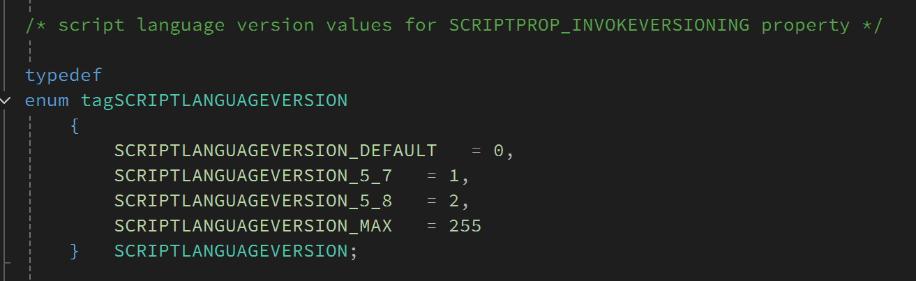

These are the "documented" values in the Windows header files:
Opus sets the version to 2 by default.
