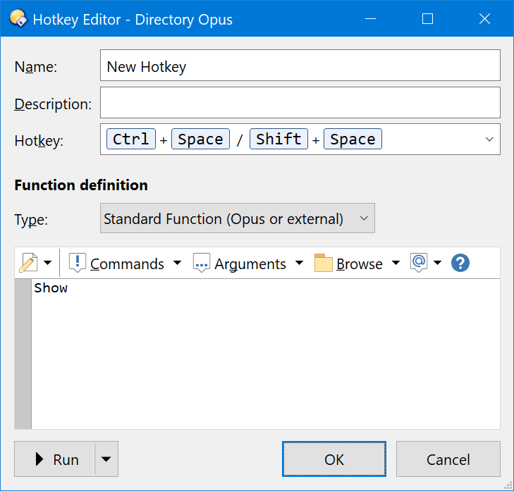

Thank you, this way can only add regular shortcuts, for example, you can addDel,Ctrl+DelorShift+Del in the shortcut editor, etc.
You can addSpacein the shortcut editor, but there is no way to addCtrl+Space orShift+Space,etc. because it does not support such entry, is there a way to solve it?

both shift and ctrl works with space for me
Are you using a US-style keyboard for this or an IME of some sort?
Yes, I'm not an English user, I used the input method but I turned it off and it still didn't work.
