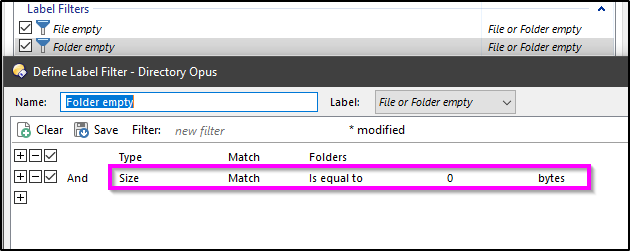

My plan is to label empty folders (which contain nothing, not even empty files or folders). So I would need to be able to add something like Size | Match | Is equal to | empty in the magenta box in the screenshot below:

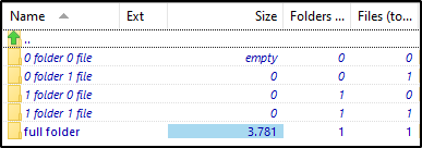

The way I set it up, the label (here: italic font) is applied not only to the truly empty folder, but also to any folder with 0 bytes - regardless of the amount of empty files or folders in it. See the first 4 folders:
I hope, anyone can help me? Thanks!

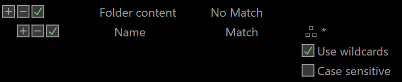

If you're using Opus 13, you should be able to do it with a Folder Content filter:
  • Folder Content - No Match:
    • Name - Match - * - :white_check_mark:Use wildcards.
In Opus 12, it would probably require a script column, as there wasn't an easy way to filter a folder based on what it contains (rather than properties of the folder itself).

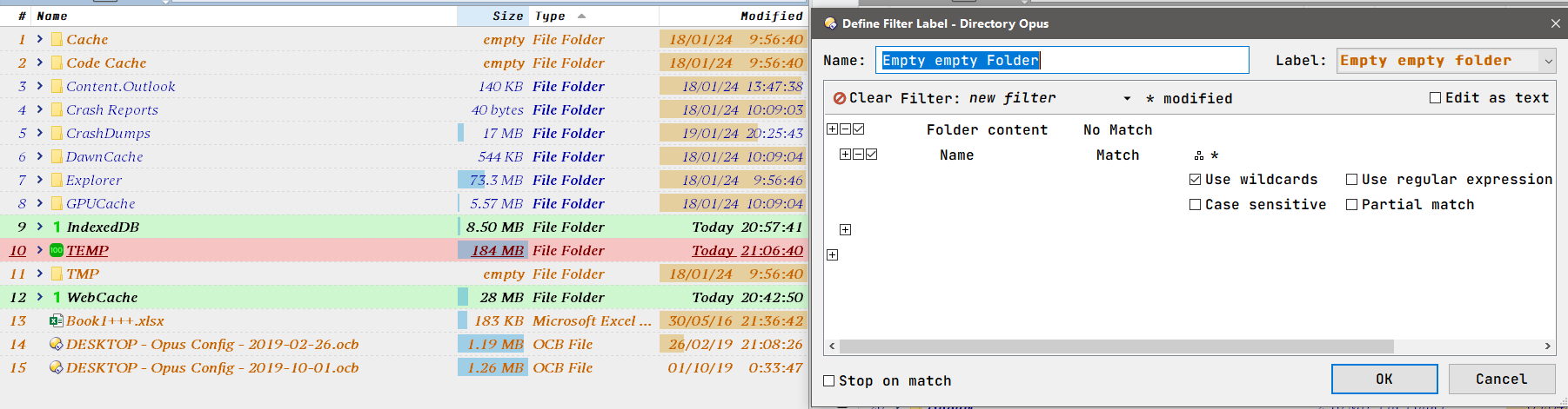

why do I also have all the files labeled with this filter?
You need to add a Type clause to make the filter only apply to folders.
