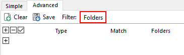

I'd say with the right parameters Print FOLDER gets the job done.
Or were you looking for something different?

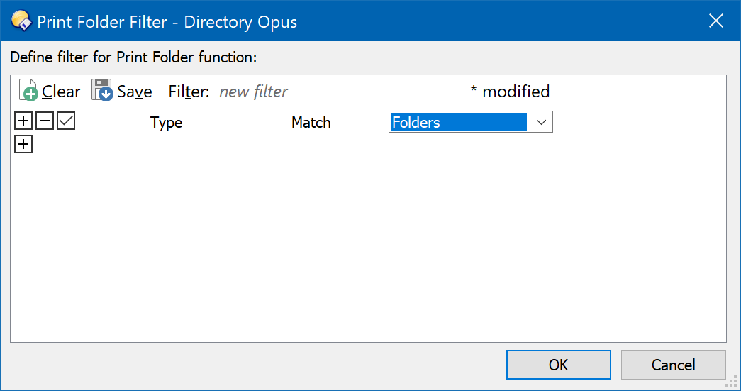

Lxp's screenshot is from the Find > Advanced panel, which is a convenient place to go to to edit filters. The filter editor is the same wherever you go to edit them, though. It'll look like this if you click "Define" next to the filter option in the Print / Export Folder dialog:
You should create a new filter and make it look like the one in my screenshot. You can then save it and give it a name, if you want to, which makes it easier to use again in the future. (In Lxp's case, he named the filter "Folders", but you can name it anything you want.)
You'd only need to use/define that filter if you wanted your listing to only include folders and not any files.
