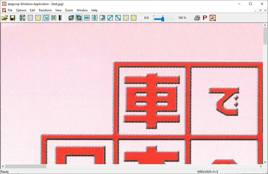

In this case it extends the width to the next multiple of 16, which is 4304, adding 13 pixels wide "garbage".
Here you see where the name "Minimum Coded Unit" comes from: There are always full-size MCUs coded in the image. The encoder adds the "garbage" appropriately.
Now after rotation the bottom edge is perfect, and the garbage strip appears on the top edge of the image, which looks as follows:
Usually I choose this method, because nothing is lost.
