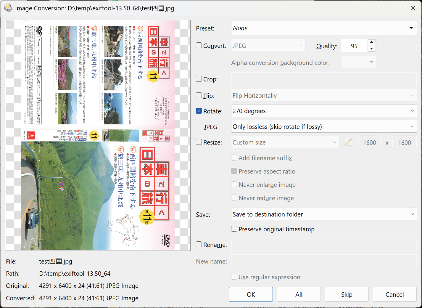

Lossless JPEG rotation fails where JPEGTRAN works
I tried losslessly rotating a JPEG with the IMAGE command. It aborts if you tell it to only use lossless mode. Meanwhile, the "jpegtran" application can rotate it without issue, and is confirmed lossless. So clearly there is some difference between how they operate.

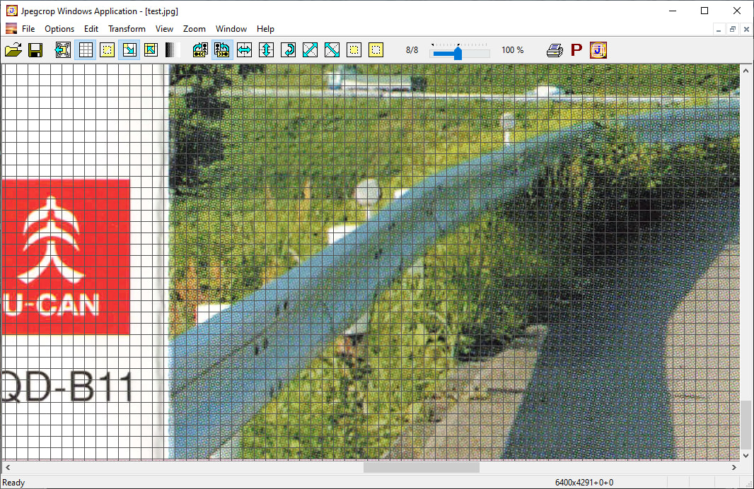

jpegtran can rotate it, but it leaves a thin strip at the bottom which you may not notice.
This image has a 2x2 subsampling, so the MCU size is 16x16.
4291 leaves a remainder of 3 in division by 16 (4288 is next multiple).
The thin 3-pixel strip from the right edge is copied to the bottom edge.
I have written the Jpegcrop program specifically for the purpose to visualize such situation:
The "Block Grid" is the MCU block grid.
There are several options to deal with this case.
jpegtran provides the -trim option.
