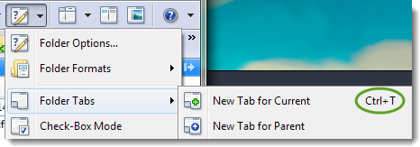

Ctrl+T is defined on the default Menu toolbar.
From Customize --> Keys you can see which keys come from Toolbars and which are Hotkeys and it is here that you would define a new hotkey if that is what is required.
Regards, AB
[quote="aussieboykie"]Ctrl+T is defined on the default Menu toolbar.
Regards, AB[/quote]
[...] Images snipped
Thank you, nothing like images to help it soak in.

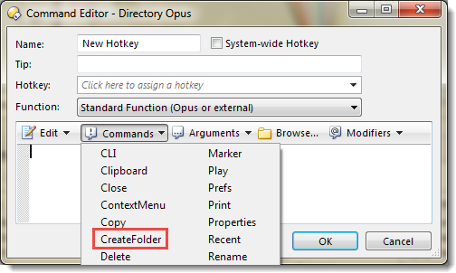

I still have one question though. Where does on find a list of the possible commands/functions. The drop down list, of course, but for example .. on my setup 'Go NEWTAB' was not on that drop down.
I've also lost the ability to create a new folder with 'Ctrl+n', I'd like to make it a global hot key. How would I go about finding the command for creating a new folder?
When you create a new hotkey in the command editor, select Advanced mode.Pick the command you want, in this case Go, and then use the Arguments dropdown to refine what you want to do.
Regards, AB
The commands are described in the manual.
Sometimes (actually often, in my experience) the command editor is surprisingly easy to navigate even when you don't know exactly what you are looking for.
