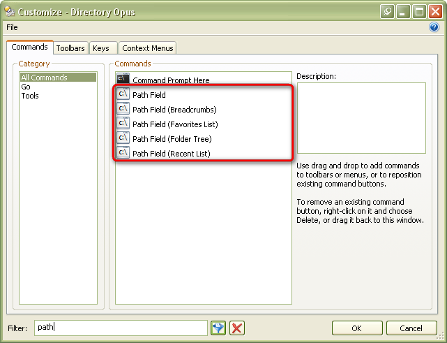

While trying to customize my bars o take the maximum advantage of space (namely: I was trying to remove the label from the path box) I ended up removing the path box as well, as pictured, and I can't get it back! What do I have to do?

Since you seem to have already made changes to the toolbar that I presume you'd want to keep - and since I don't see the default "Pathbar" that has the "path box"... you can specifically go to:

@steje: ahhhhhhhhh this is it! Darn, I didn't think of checking in the commands list, I was fiddling around with the toolbars settings only... thanks so much!!!
Solved :slight_smile:
Sure, though for what it's worth - you don't have to "replace" your customizations using abr's suggestion. You can just bring back a default menu or toolbar, and then just use it to copy or drag items "back" to your customized toolbar that you may have deleted...
My point was that there is no default "Pathbar" in that "Default Menus" page at all for you to have used for the specific thing you needed.
Either way, you should also know that you COULD have put the "path box" back by "fiddling around with the toolbars settings only" as you were... it's just not added in an "obvious" way like a "button". Instead of adding a "New Button" when in Customize mode, you have to add a new "Spacer"... then you can right click on the Spacer and select the "Field Type" for the spacer/box. Most of the 'drop down' looking "fields" in Opus are listed here (Content Type, Filter, Path, etc).
