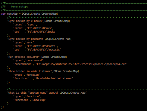

When used with its original "three button" type button (which I include hereafter), the configuration can simply be opened with a right-click on the button. Once the script opes, you are immediately in the right place to add items:
Of course, you should be careful not to corrupt the syntax of the OrderedMap which I used for the configuration. The way I implemented it should more or less explain itself to any “IT lite” person. New items must always get a unique name (for display in the menu) plus certain commands and parameters, depending on the kind of command you need. Three methods are included: function, sync, runcommand.
