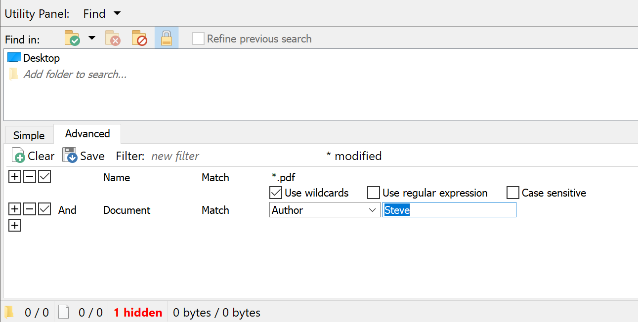

You should be able to via Tools > Find Files > Advanced. e.g.:
