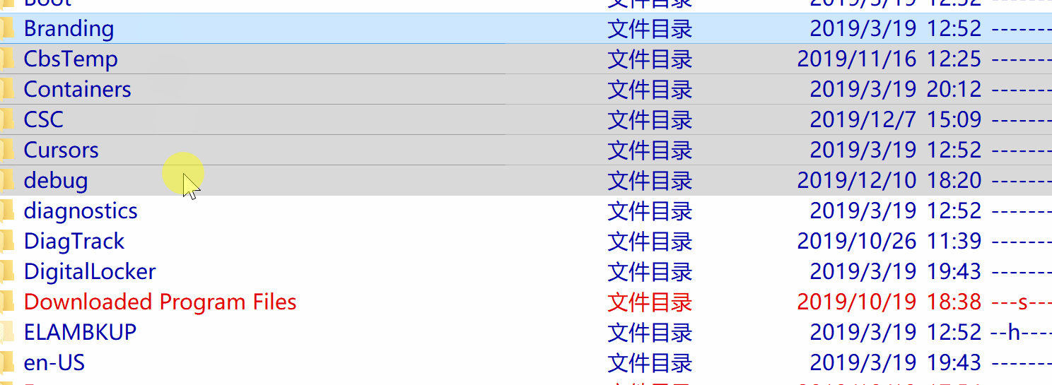

The left mouse button is set to Auto-deselect. When dragging and selecting files, the selected files can only be increased and cannot be dynamically adjusted.
I just noticed that if I drag from the background, the selected files can be dynamically adjusted.

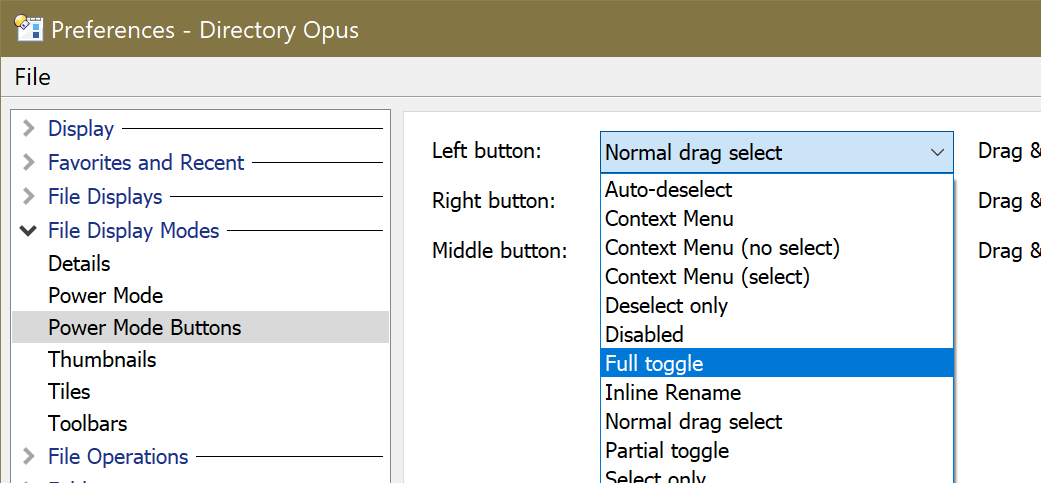

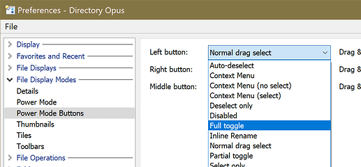

Full Toggle and Partial Toggle work like that.
Normal Drag Select also lets you click a selected file to deselect it, and drag from there to deselect others.
I think the normal thing to do with Power Mode is to use multiple mouse buttons to give yourself more than one mode to work with. That's how the old systems it aims to emulate worked.
