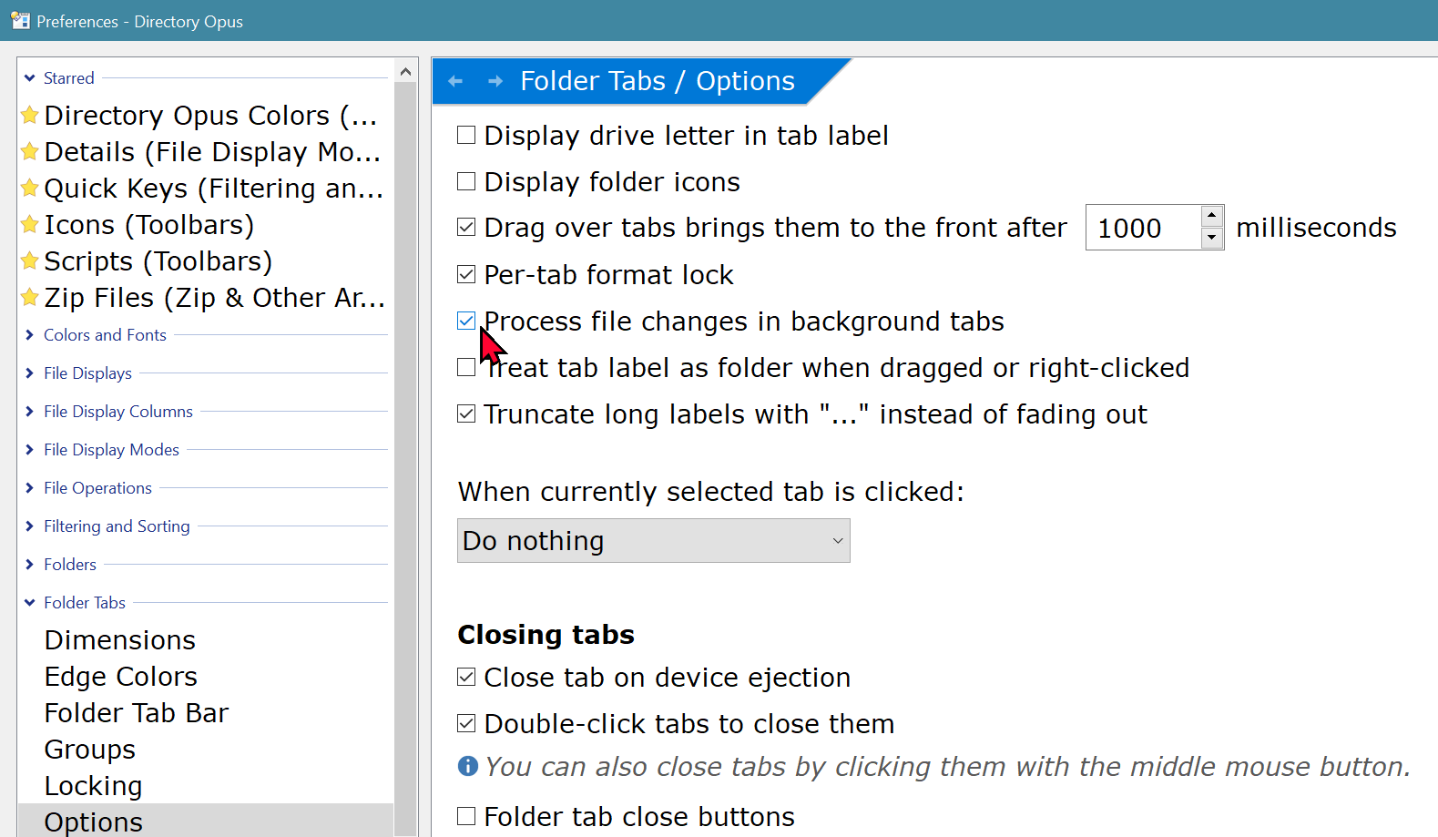

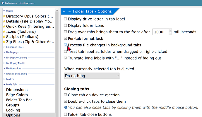

The code works but only if "Process file changes in background tabs" is selected.
