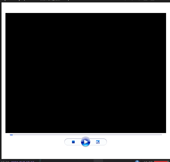

It does work via the ActiveX plugin, but the interface is ugly. It would be nice if Opus could create a copy of the small video file and then load it for preview.

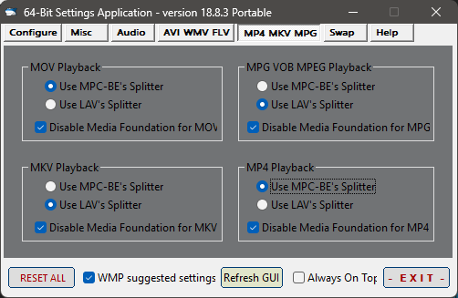

Found a solution: Switch video decoder using Shark007Codecs version 18.8.3 portable.
So the issue was with the video codec being used, not part of Opus. (That UI in the last screenshot isn’t Opus).
