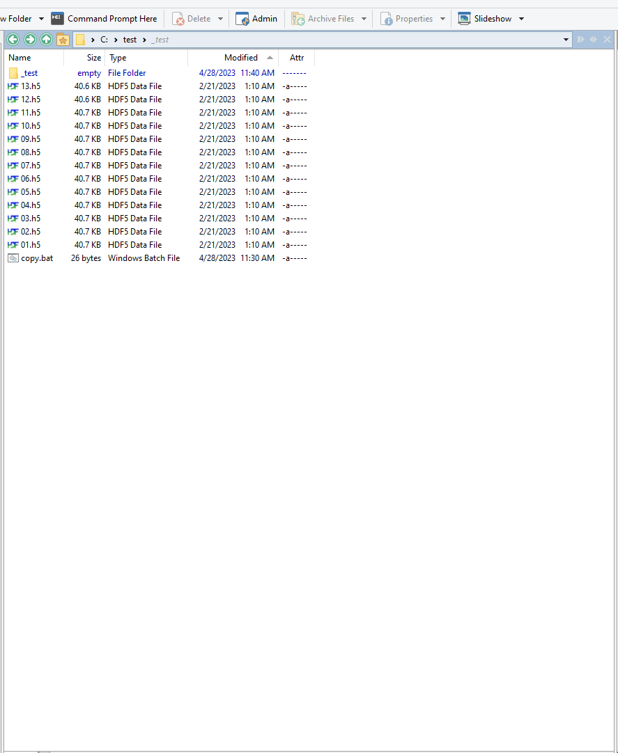

copy
Edit: forgot to mention that it also runs fine from the standard windows file explorer
