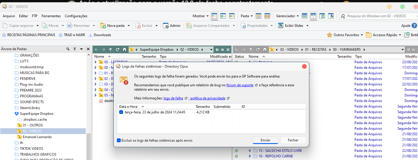

Hi, thanks for replying. well, basically...i downloaded version 13.7 and on the second day, the update to version 13.8 appeared. as for the crashes, they started after this update and they are a bit annoying. sometimes when I try to open a folder, sometimes when I try to go to "customize" sometimes when I go to "rename" and sometimes during normal use opening the folders in the explorer. I still can't figure out what's causing it. I found in Help* the option to send the error logs. but before nothing appeared.. but now when I type this message there is something there. well, that's it.

Did you send the error logs in? We need those to understand what's crashing.
