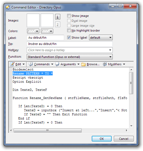

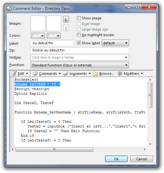

You just need to add a Rename command to the button. (Without any command, the script doesn't do anything on its own.)
Rename PATTERN * TO * is probably what you want, like this:
