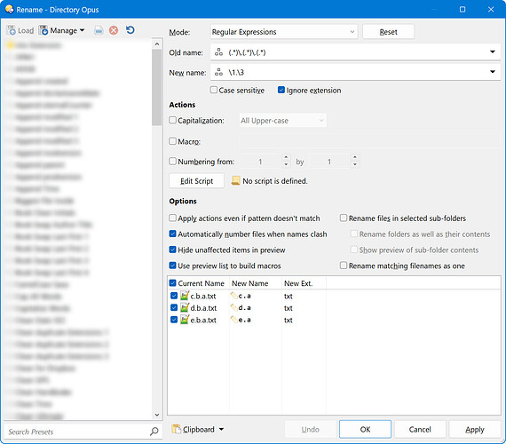

I have multiple files c.b.a, d.b.a, e.b.a, etc. How can I rename them and remove the .b part of the name? So the file names become c.a, d.a, e.a? Notionally, I want to mv *.b.a *.a, but that does not work as the * matches the fullname and I get c.b.a.a, d.b.a.a, e.b.a.a. Is there a way to do this with wildcard? If not, how can I do this, from the dopus gui, with regular expressions? (I say gui because I do not know how to use dopus scripting commands.)

Yes, that's the right tool. Try
Parameters for the Advanced Renamer
Mode: Regular Expressions
Old name: (.*)\.(.*)\.(.*)
New name: \1.\3
Ignore extension: checked
