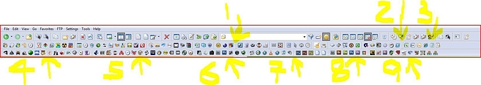

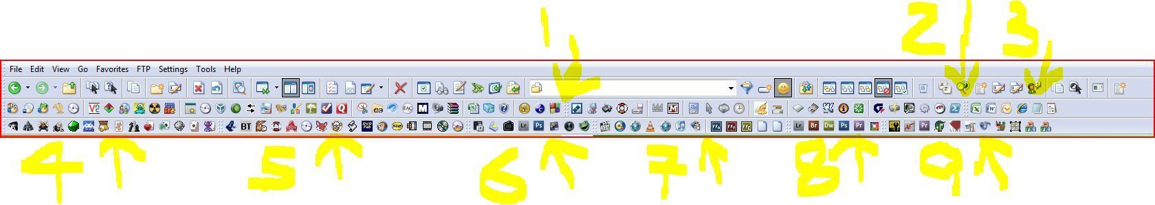

as you can see i have 9 toolbars on two rows. these are probably all the shortcuts that i need.
sometimes i like to hide a toolbar or 2 but when i unhide them they do not remember where they where - they put themselves on a third row.

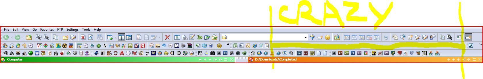

as for the toolbar toggle if i set it at 2, 900 it puts it on it's own on line 3
800 puts it just short of the middle of the dual lister 900 put it on the next line. i have posted a capture with 800 - think the problem might have something to do with all the crazy space after my 6 icons. or it maybe because i am using dual lister?

That toolbar with the huge gap after it: If you go into Customize mode, is there a spacer after the icons? If there is, delete the spacer and see if that fixes the problem.
there's no separator
