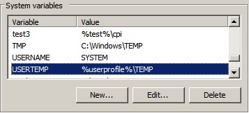

I've got a System environment variable %USERTEMP% which is defined as %USERPROFILE%\TEMP
I use this to stop my desktop becoming a dumping ground for temp stuff.
Windows Explorer.exe and commandline.exe handle this environment variable fine, but it results in an error message in Directory Opus.

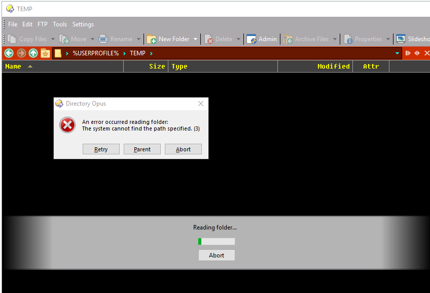

Opus correctly converts it to %USERPROFILE%\TEMP in the toolbar, but throws the error below. If I type %USERPROFILE%/TEMP directly it works.

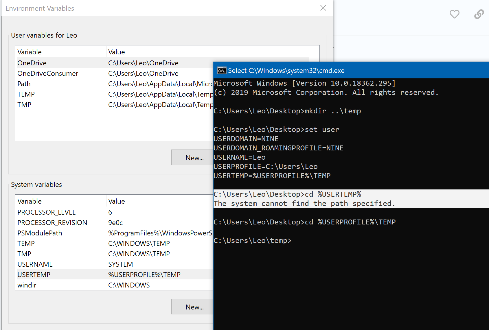

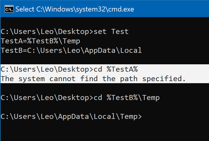

Testing the same thing in a Command Prompt, it doesn't look like it works there either?
It doesn't work either way around (A pointing to B, or B pointing to A):
Are you sure this is really supported by Windows?

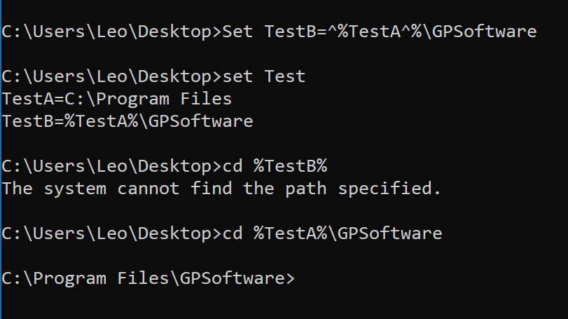

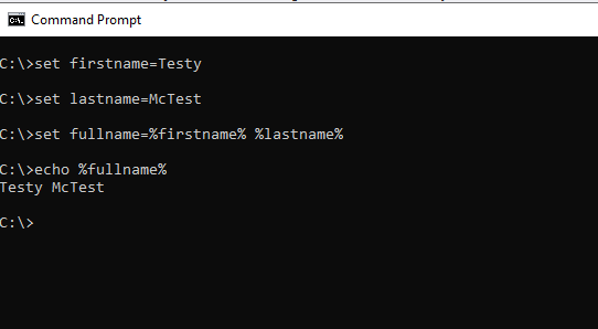

If you do that in a command prompt without escaping the % characters, the command prompt expands the current env-vars at the time the set command is run.
Type set fullname and you'll see it is defined as Testy McTest and not %firstname% %lastname%.
That's why the ^ are in the first line of my last screenshot, to escape the % characters when setting the dependent variable, which then does not work as the command prompt does not seem to actually support nested variables.

But I've just demonstrated that it doesn't work in cmd.exe...

  • Make a new system environment variable %USERTEMP% = %USERPROFILE%\TEMP
  • Make use of this new environment variable in CMD, Explorer, XYPlorer, FreeCommander and observe that it works
  • Make use of this new environment variable in Opus and observe that it does not work.
I have not tried the others, but it does not work in CMD:
Based on this and the other things I linked, I don't think it is really supported by Windows at all.

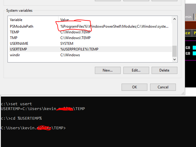

It does work. And it works in CMD, Explorer, XYPlorer, FreeCommander And if you look at the screenshot you posted yourself. You'll see an example of nested Environment variables used in PSModulePath.

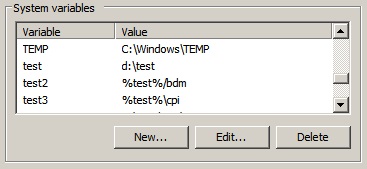

For some reason Opus doesn't pick up all environmental system variables from the registry. Some of the built-in ones work, so do user-defined ones.

System variables including %userprofile% seem to be a bit special (no idea why).
36%20-%20Environment_Variables

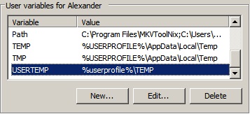

Funny enough, these variables work when defined as a User variable:
27%20-%20Environment_Variables

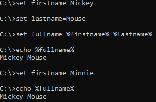

I think what @leo was getting at, @reach4thelasers, is that nothing reevaluates the final version of the environment variable. Below, you can see I set the fullname variable to firstname lastname. Then I modify the firstname, but you can see fullname remained unchanged.
So, it works, but only the first time the environment variable is set. To a lot of people, including me, these aren't nested environment variables because the inside environment variables (firstname and lastname, in my test below) don't stay stored as an environment variable. Rather, they are immediately resolved (or "de-nested") upon assignment. That's the reason fullname doesn't change from "Mickey Mouse" to "Minni Mouse" but stays set as "Mickey Mouse".

PSModulePath is only used by PowerShell. Maybe it has special rules for expanding env-vars multiple times. I think the PATH variable may also have that. But those rules don't apply generally.

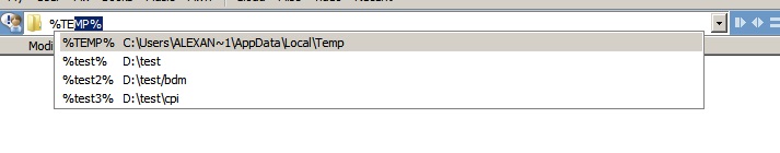

Yes, sorry, that was a bit confusing. %userprofile% works just fine. What I meant was: system variables, that include %userprofile% in their values don't show up in Opus' list of suggestions. They don't work in the DOS prompt either (Iike in your example). The other variables in my examples do, e.g. cd %test2%.
So I think it's more a Windows problem rather than an Opus bug.
