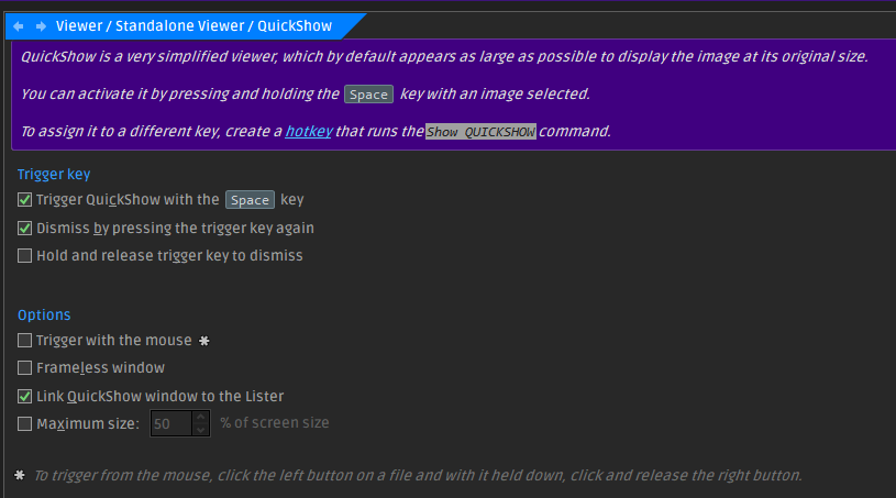

My Settings for 1a - 1d

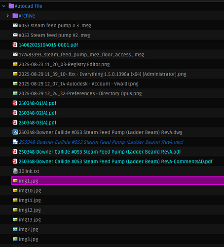

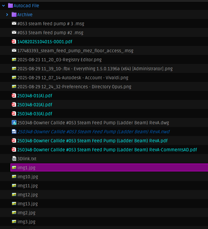

Screenshot of typical folder contents:
Ideally, i’d like Quickshow to display every file type over the Directory Opus window left monitor, after hitting down arrow keys the next file type to be selected, with Quickshow displaying the preview, irrespective of file type.

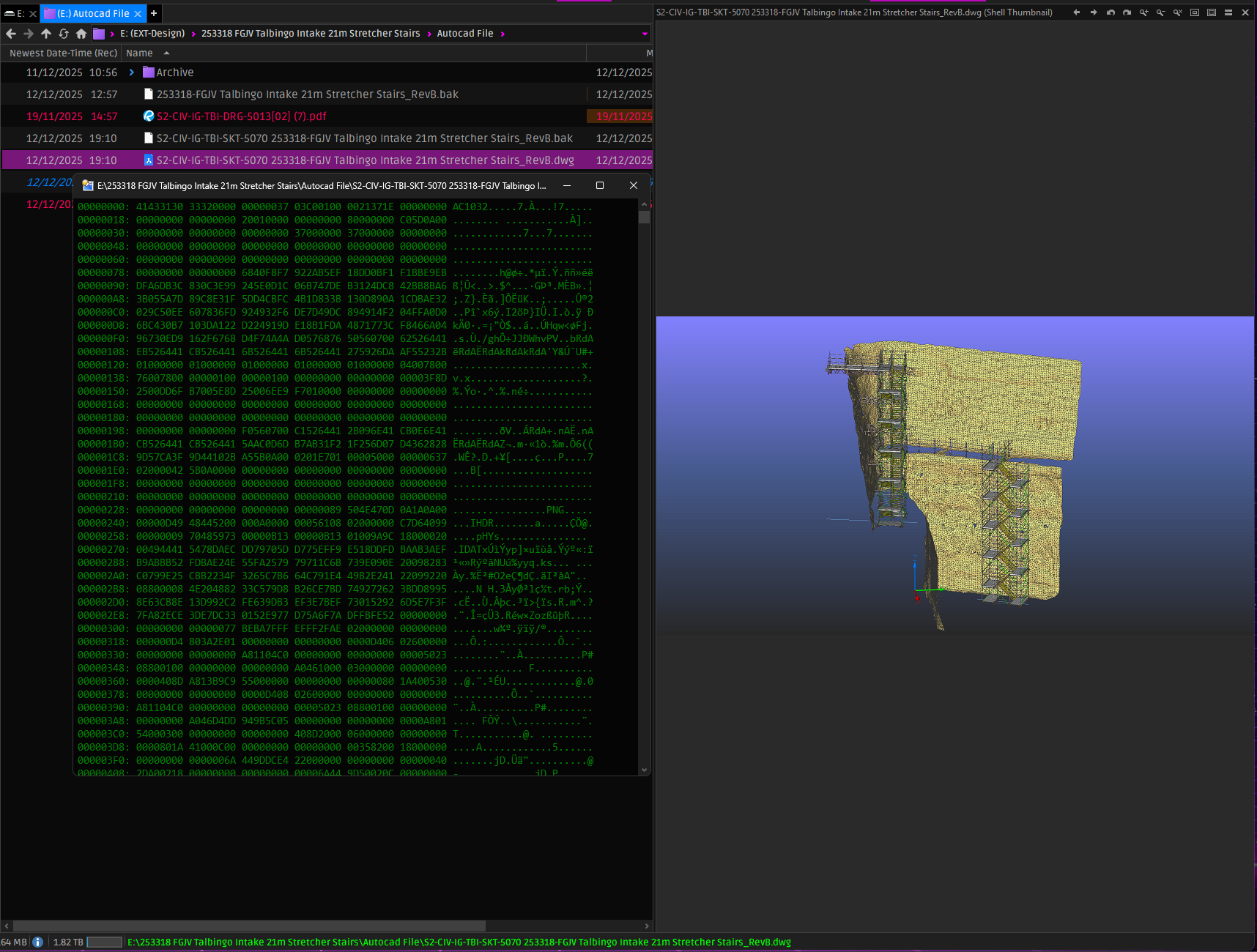

Lastly ‘dwg’ ‘rvt’ (Revit Project) and several other file types are displaying as hex.

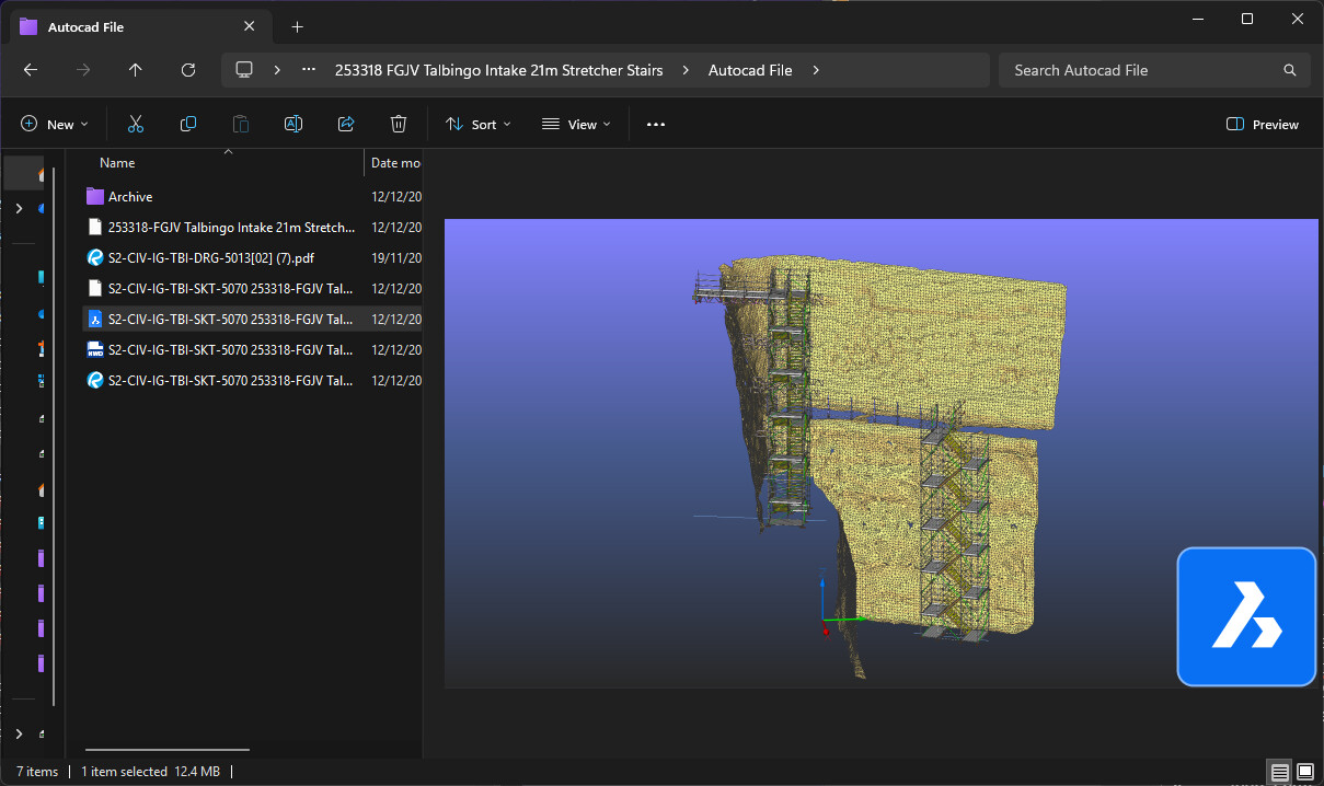

In contrast, Viewer pane shows a preview for dwg & rvt (Shell Thumbnail) in brackets in titlebar. For dwg probably AutoCAD, BricsCAD needs to be installed. I know the free app Autodesk DWG TrueView will provide thumbnail preview icons, maybe that’s where the Shell Thumbnail source is?

Testing with PDF’s opened in Revu, I’ve resized to fit onto the 27 inch monitor (the one DO has the Lister), and set the PDF size to 100% which are A3 Landscape. 1 sheet fully fits on the display. So what i’m seeing with QuickShow is the PDF on the main 38” monitor stretched full width.
>>If so, try resizing the window to a size that will fit. The size you set should be remembered for non-image files automatically.
It doesn’t remember size with the settings in the first screenshot, but i’ve just ‘checked’ Maximum Size, set to 100% and can confirm both PDF’s, DWG’s, and all the other file types, now open exclusively on the monitor the Lister is on, and they all seem to retain the 100% consistent size. Yeah this is good.

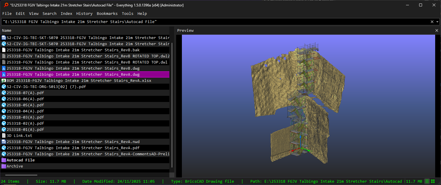

Hi any further progress on having dwg's previewed with Quickshow?
Still showing hex here, but the Viewer Pane actually shows the dwg preview.
I can supply some dwg's for testing if needed.
I have BricsCAD v26 & AutoCAD 2026 installed, i'm quite certain Autodesk DWG TrueView (free viewer) gets the shell icons too.
Both BricsCAD & AutoCAD have a Thumbnail Preview setting to define the size, up to 2560x2560

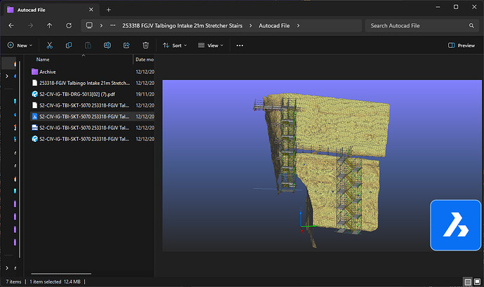

Screenshot
Here's Everything Preview pane:
And dumbo Exploder:
