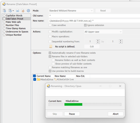

I would add the shooting time or parent folder name to the filenames, to make them unique. That can be done using the Rename dialog.
That will also fix the problem with the flattened folder interweaving different photo sets instead of grouping them together.
The Duplicate File Finder can be used to clean up any duplicate images once done, by setting it to use MD5 Checksums to find identical files with different names. (Assuming you can't delete the flattened directory entirely and start again without losing any photos, which would be easier if it's possible.)

I agree with Leo about renaming the files.
If it were me, I'd first separate out any photos without a Date/Time Original (a Picture metadata column) then rename the photos with a Date/Time Original by the Date Taken:
When the date format YYYY-MM-DD is used, the photos can be sorted chronologically when sorted by filename.
And make sure to check this box in the rename dialog:
I'm using Rename with the datetaken field, working perfectly. But it is taking forever, renaming files at a rate of one file every second. Is there a way to speed it up? Can it run multiple threads?
