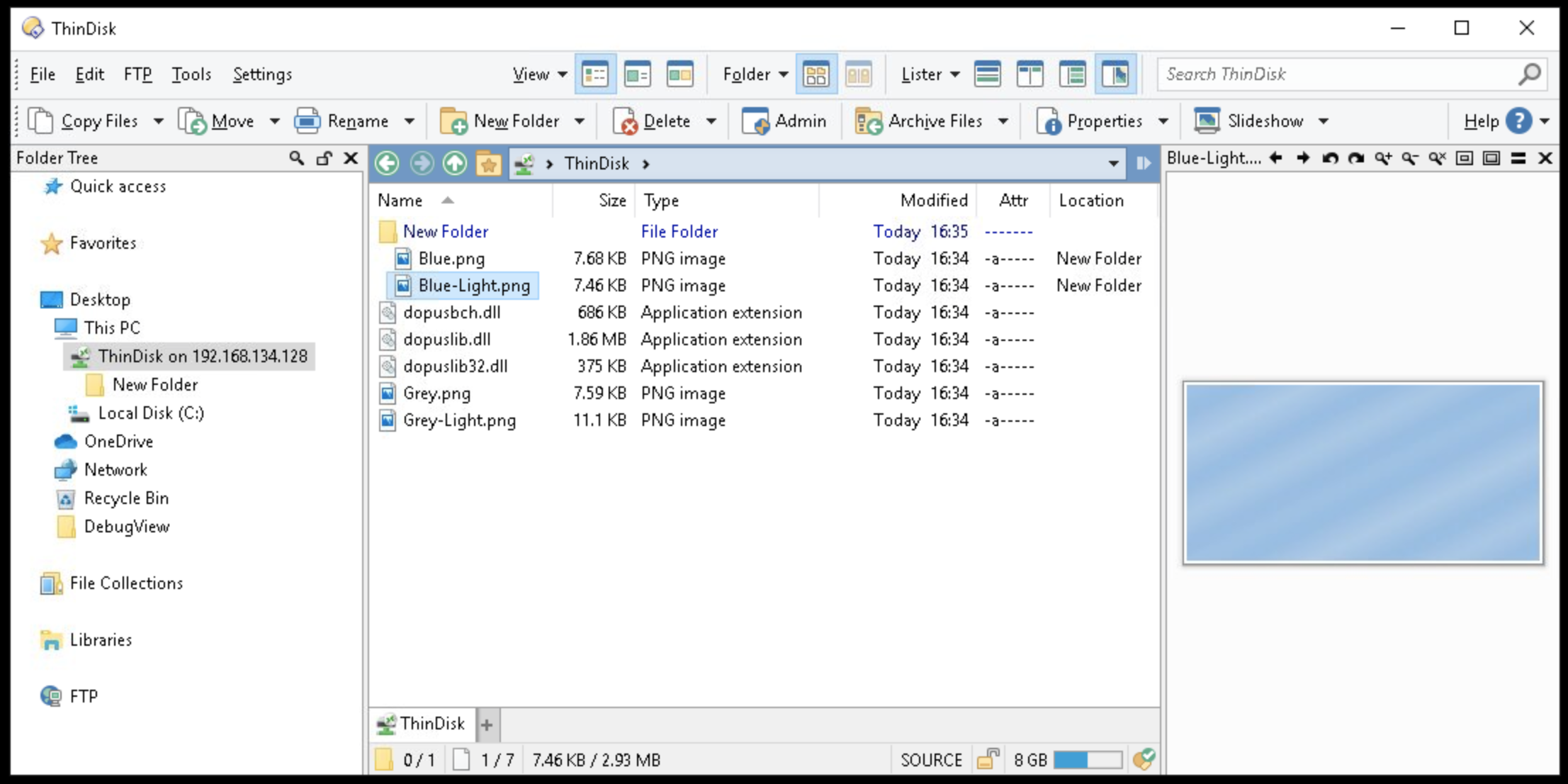

But once I was set up, everything seems to work fine without having to do anything. I'm able to copy files to and from the ThinDisk drive using Opus on the remote machine (viewed inside the web browser):
