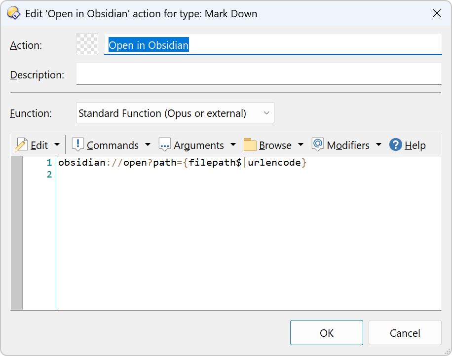

Add a context menu so that you can open a right-clicked file in Obsidian:
  • Open the Settings > File Types... menu
  • Select the .md markdown file type and click the Edit button
  • Select the Commands tab
  • Select the Context Menu subtab
  • Click the New button
  • In the "Edit new action for type: markdown" dialog, choose "Run an Opus Function" from the Type dropdown
  • Enter a name for the action, e.g. "Open in Obsidian"
  • In the large edit area at the bottom, enter
obsidian://open?path={filepath$|urlencode}
...which adds an "Open in Obsidian" item to the context menu.
