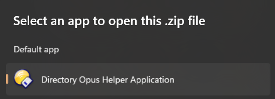

Thanks. The "Directory Opus Helper Application" only shows when i Open With for .zip files:
For 7z files, its missing.
I pointed 7z files to dopus.exe, but then it uses the dopus program icon for all 7z archives.
I prefer it the Dopus Helper application way, which gives it a proper system archive icon:
How can I get the helper application to show for all archive types so I can set it to "Always"?

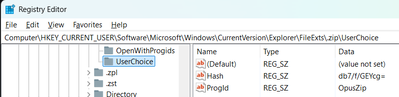

I did some digging and found this, but am not sure how to transplant it to other archive types.
Thanks!
