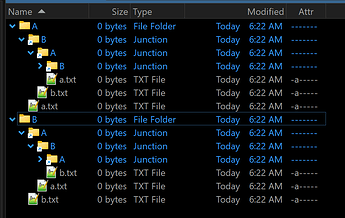

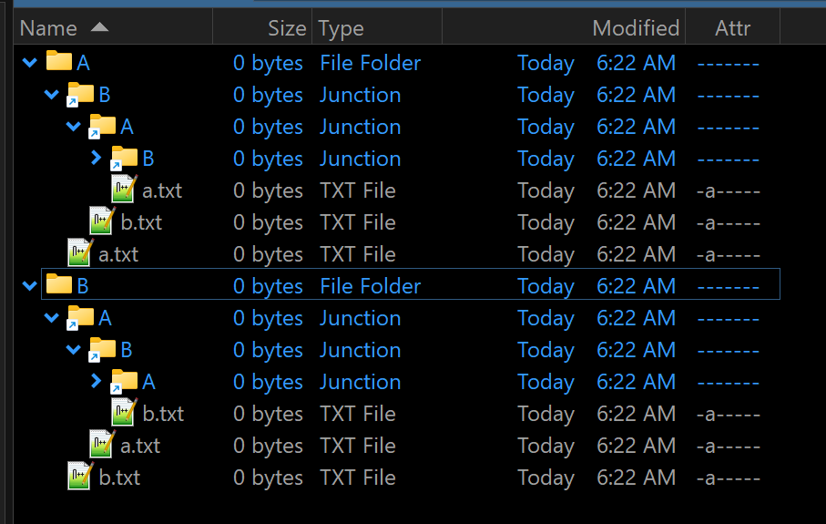

I tried this by setting up an infinite junction point loop in D:\Temp:

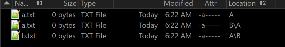

I then started a search in D:\Temp for *.txt, and it finished immediately and found only these files:
Which looks like it's working as it should - as soon as it detects that a junction is recursive it backs out of that branch.
