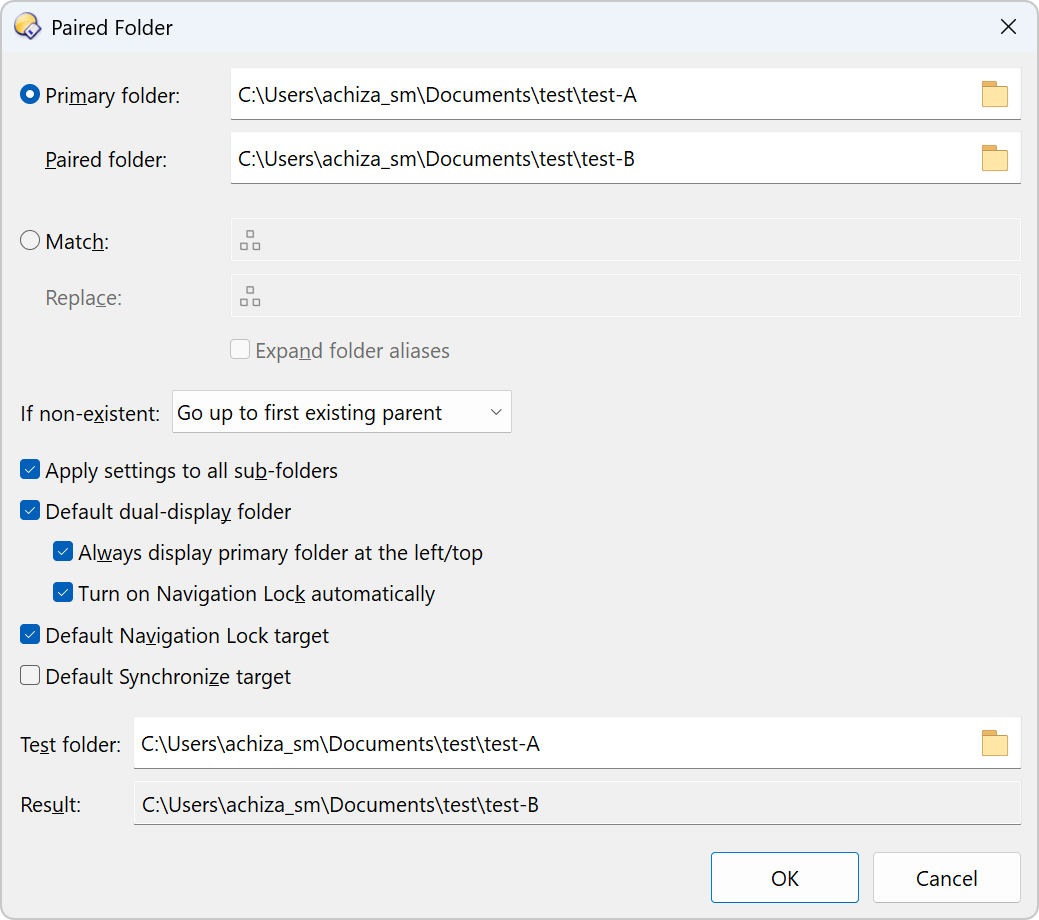

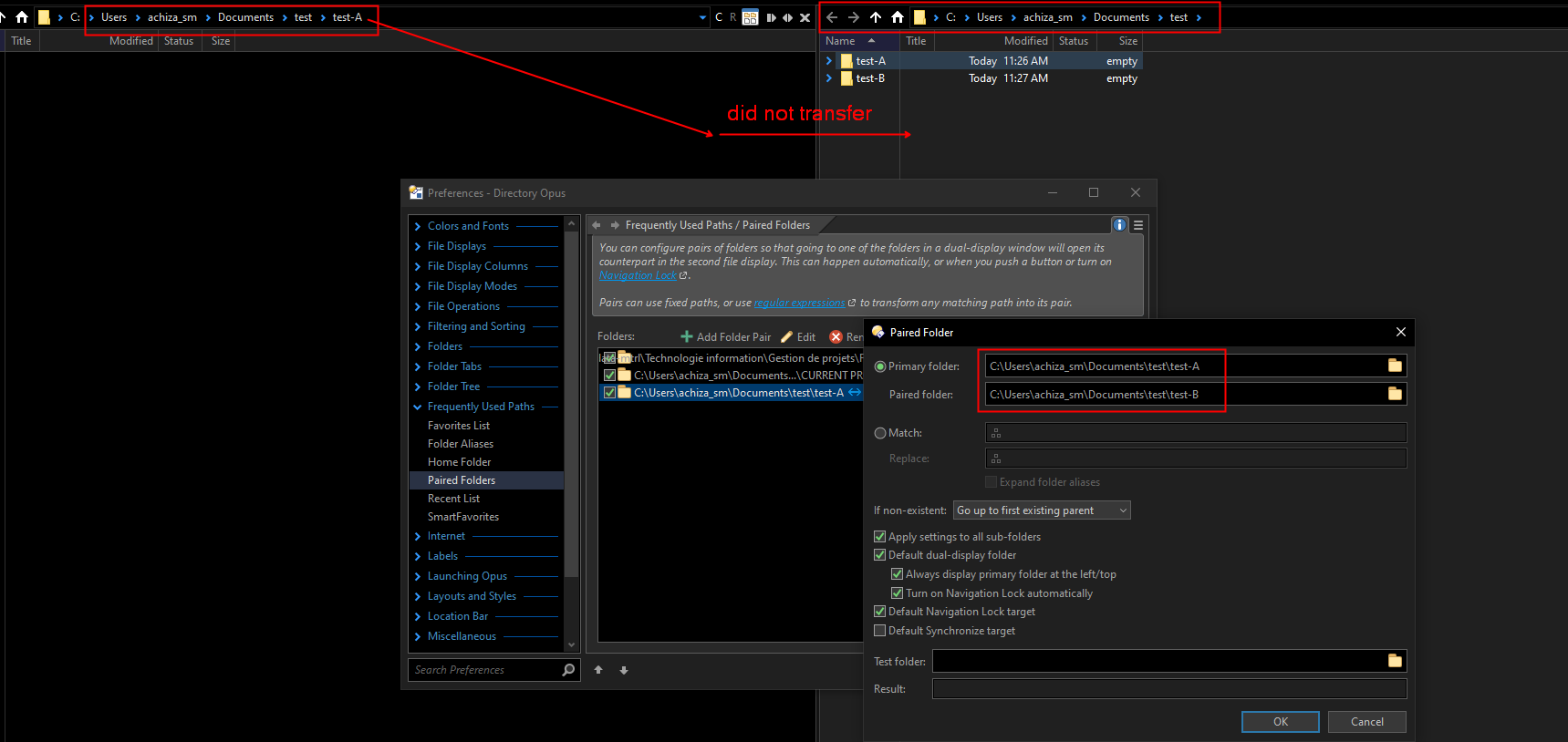

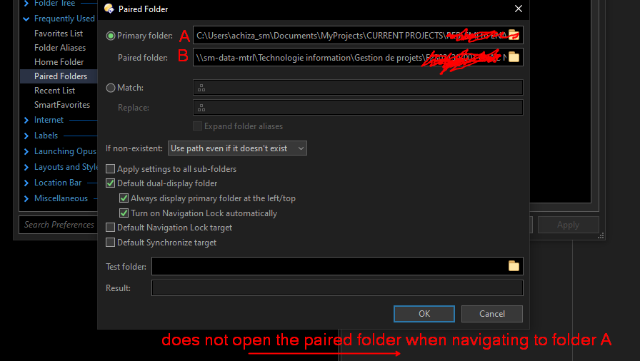

Hi Leo, I have tried multiple variations of options selected, making sure Navigation Lock is active, but it doesn't seem to open the paired folder on the B lister. I also tried some more basic examples based of the documentation, and it doesn't open the paired folder either.

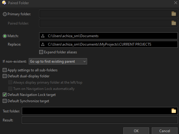

You need to escape the backslashes in the first example. The second looks ok. Start with something simple and self-test with the Test folder field.
Could you clarify what did I do wrong here
perhaps its a matter of conflicting configurations, or access rights on the company PC
Looks okay. What happens if you paste C:\...\Test-A into the Test folder field?

nothing :frowning:

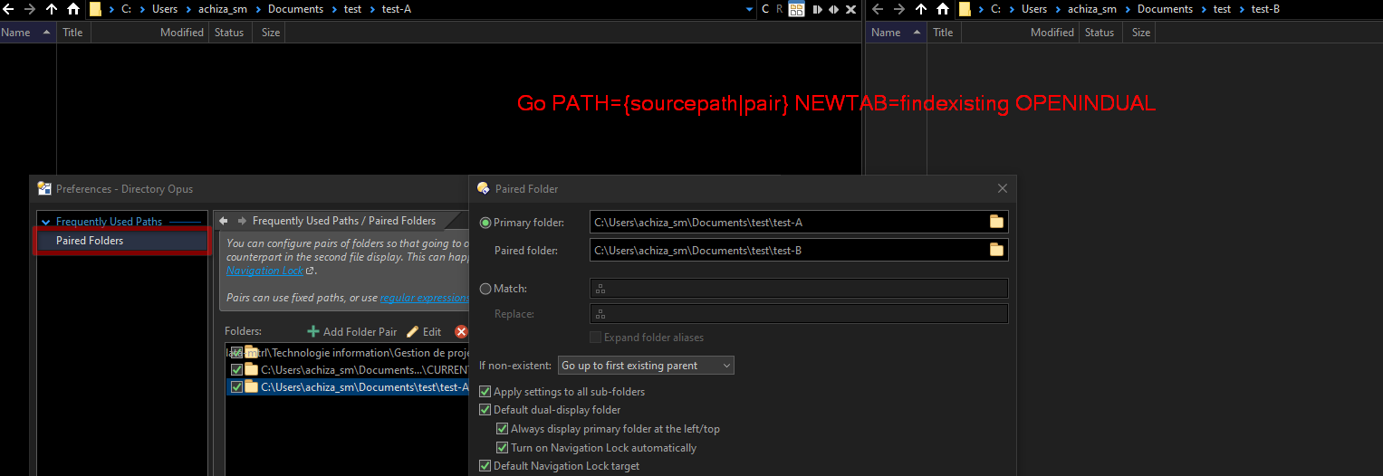

I am on the latest version on my personnal laptop. When running the test inside the configuration window, I get the right output, but that is not a proper in-situ test.

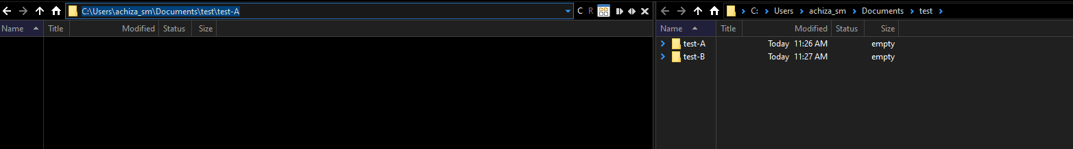

What does work however, is going into the single lister mode (F6), then opening Test-A, then going into the double lister mode (F6 again) - which opens Test-B.
In other words, I need to start from a single lister view to have Test-B open. The script executes when the view is changed.
Yes.
That totally works, applied the script to my mouse-bacground-events (instead of kb shortcut) - love that feature.
