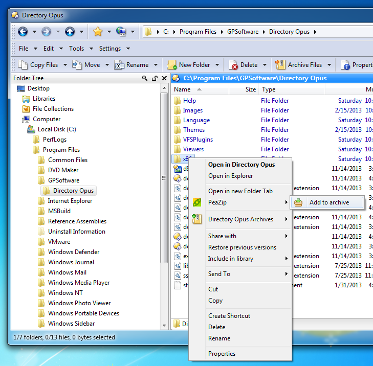

In the image I have posted below, my peazip appears in this subfolder and it looks like yours, with the "add to archive," but it does not do anything when clicked. you can also see explorers context menu on the right
with the commands that should be shown.
also in the next image it shows 2 entries for peazip when i right click a recognised format.
Is that Folder Options sub-menu (with the folder labels etc.) something you've customized yourself in the File Types editor? If so, can you show us how it's defined?

That said, I just installed Peazip 5.20 as well. Context Menu worked fine like with Leo. I then moved that weird Peazip entry that also got created on my system under a new 'Folder Options' sub-menu myself - and it immediately stopped working. I can't fix it by moving the item back (in fact, it disappeared after I added it under the sub-menu // wasn't there when I went back to re-edit the menu.
Note: by re-running PeaZip install, and selecting to reset the configuration... I got the PeaZip context menu definition back at the top level of the menu. However... it also doesn't seem to work. Selecting the one 'Add to Archive' menu item doesn't appear to do anything. But it's also not clear to me if PeaZip is sending an archive to some pre-configured destination folder. The Settings interface isn't very clear in this regard...
Somethings rotten with the integration here it seems. I don't really understand why this entry in Opus actually works in linking to PeaZip's new style context menu entry under HKCR*. Weird...

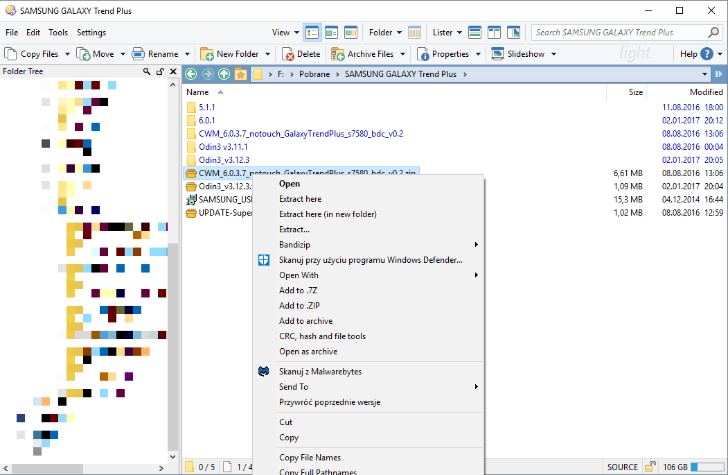

I really hate to be that guy that resurrects an old post buried years ago, but, yeah, I have an issue with Directory Opus (12.3, Light) and PeaZip (currently on newest version - 6.3).
The solutions I've found on the web are for Directory Opus 10, outdated (there is no option for Windows menu integration anymore, or at least there is no option for Light version).
As you can see there are two "PeaZip" menus, and both are showing "Extract..." only. Shift+Right click does not change anything. It also shows "Extract..." when (for example) uncompressed folder is selected.
If I disable Cascaded Menu in PeaZip System Integration config wizard:
