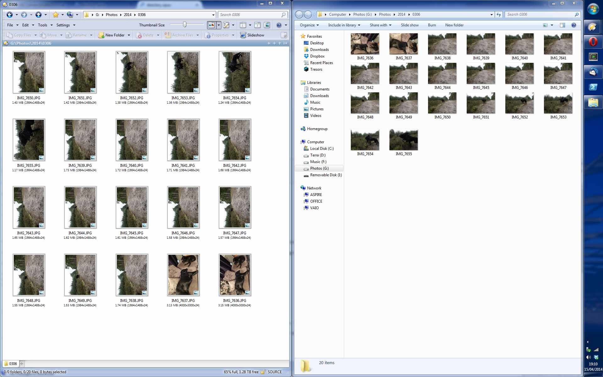

I recently bought a new Canon Ixus camera and my photos always display sideways when I view them as thumbnails in Directory Opus. This was not a problem with my old camera. I have searched the web in the past for a solution, but haven't come up with anything. Today it occurred to me to test the view in Windows Explorer and Explorer does indeed display pictures correctly. I am attempting to attach a picture to show you what I mean. It's a big screenshot, but I've set the quality to low to keep the file size down. I should probably add that I import my pictures by dragging them directly from the SD card to the main hard disk in Dir Opus. I do think there's something odd about the camera pictures, but I haven't managed to find a setting either on the camera or in Opus that would make the pictures display properly.

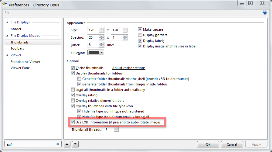

Do you have this option checked?
Adding to the previous reply:
Try toggling:
[ul][li]Preferences / File Display Modes / Thumbnails / Use EXIF information (if present) to auto-rotate images[/li]
[li]...and the similar options under Preferences / Viewer / Standalone Viewer[/li]
[li]...and Preferences / Viewer / Viewer Pane.[/li][/ul]
If they are rotated incorrectly when the option is off and correctly when it is on, then everything is good and Opus was just configured to ignore the rotation data the camera was writing.
If they are rotated incorrectly when the option is on and correctly when it is off, then the camera may be setting the EXIF rotation data incorrectly.

Okay I have checked the exif setting and it is turned on. But turn the exif setting off and the pictures display properly. Which would imply the camera is setting something wrong in the exif data. If I look at the details then the width is the larger number, so the width and height are being set correctly.
