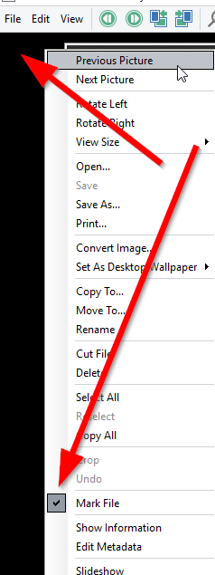

There are a couple strange observations. In this capture, you see the File menu in the upper left, the "Marked" graphic should be right below it but it isn't. But notice in the right click dropdown, it knows the picture is marked.
