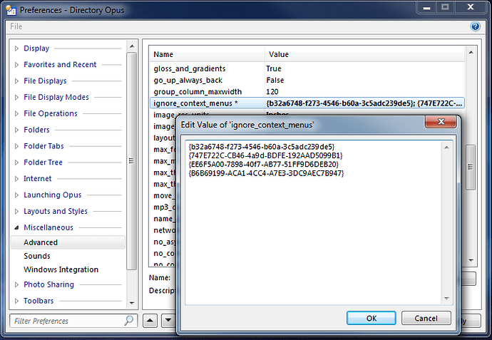

If you enable them again in ShellExView, and then add them to Preferences / Miscellaneous / Advanced: ignore_context_menus (as shown below), does the problem stay fixed?
That will have the same result as changing the internal blacklist, but I'm not sure if the blacklist will help with icon problems, as Opus does not talk to shell extensions directly when requesting icons (it just asks Windows for the icon). It might still solve things, though (depending on where the problem really is), so give it a try and let us know.

I tried this, but it does not work, even after restarting Windows.
The only thing which works is disabling those 3 Mozy Client Shell Extensions (Mozy Icon Overlay Handlers, not Context Menu Handlers) in ShellExView and then Windows must be restarted.
However, the problem arises only in Directory Opus. In Windows Explorer the icons don't have any problems, even with the above Shell Extensions enabled.
So I wonder if something could be done in Opus to avoid this.
Thanks for trying that.
I think you'll need to disable the Mozy shell extension via ShellExView as that's the only way to prevent a shell extension from being involved when icons are requested. We don't have a way to blacklist that type of shell extension as we don't call them directly.
Without the source-code to the shell extension, I doubt there is much we can do about it going wrong on the Opus side. Opus just asks Windows to supply it with the icon for each file, via a very simple API, and it's Windows that talks to shell extensions and finds the right icon. Whatever is going wrong seems to be happening within the Mozy shell extension, which to us is a black box in another room.
