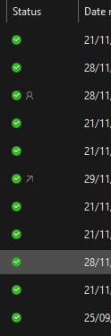

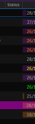

Hope I can use this topic to backtrack and ask, are there supposed to be status icons for OneDrive in the Status Column in Directory Opus similar to File Exploder?
This is FE
This is DO
Have I chosen the correct Column in DO
Thx
Turn on Preferences / File Display Columns / Icons / Show cloud storage icons in the Status column.
ah Legend, thx man. I searched Preferences of 'OneDrive', didn't think to open the query wider (less specificity) to Cloud.
